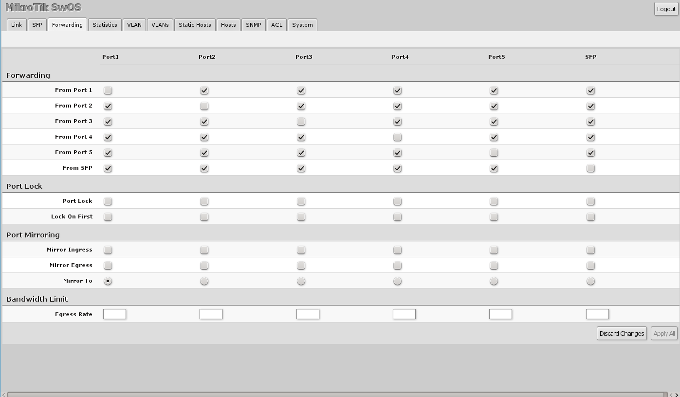

In wiki ( http://wiki.mikrotik.com/wiki/SwOS#Forwarding_Tab ) have a “Broadcast Storm Control”, but into 1.7 don’t exist. Look into attachment.
Ahh, thanks, i have added this also.
With the RB250GS the option is there with SwOS 1.7, so this seems an RB260GS related issue also :confused:
