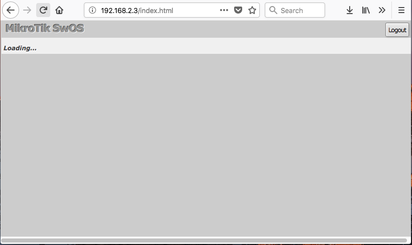

RB260GS with SwOS 1.17, is working, I mean as a switch, it keeps working, with its leds blinking, and network traffic properly passing through it, but the Web administration GUI hangs as soon as I try to access it. It happens on either linux or mac osx, safari or firefox. The index page on its embedded web server just hangs… with the html index.html partially loaded. it loads the title “Mikrotik SwOS”, the button Logout and the dummy message “Loading…”

Attached screenshot:

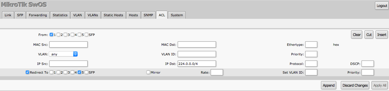

So, my fix was to create/apply an ACL rule at the switch (as shown at the second link above) that redirects the multicast packets, with destination ip “224.0.0./4”, from the port 1, coming from the router, to any/some specific port/s (port 5 in my case). As indicated on the second link above, if you want to filter multicast packets out, simply select “redirect”, but just leave the redirect port numbers deselected.
Now I have the switch rb260gs properly working, including its admin web gui.
