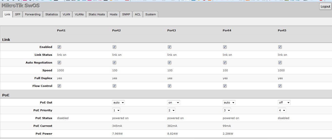

Port 1 and port 5 on the screenshot are connected by the same cable but without poe. Port 2 to 4 are connected with 3 devices - RB453G RB433GL and some other with 100mbps port. Port 2 and 3 negotiating only 100mbps but ONLY with POE enabled. When I disable it it goes on 1gbps.
