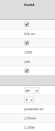

Lakis: Since you don’t know exactly what dadaniel showed you (you don’t have that switch), let me translate:
Port is enabled, link active, autonegotiation on, 1Gb, full duplex, flow control on, with POE output draining 170mA corresponding to a power of 2.35W.
So yes, the RB260GSP is capable of supplying POE on gigabit connections, as shown in the picture.
