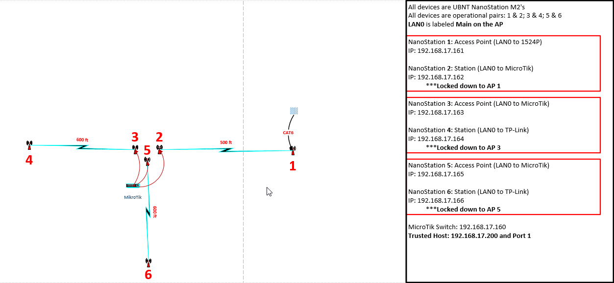

I am a very experienced network engineer, who works primarily with Dell N-Series switches and Fortigate firewalls. The absolute only reason I bought this Microtik switch is because it will power Ubiquiti products, while most other switches do not do it easily (I am no expert on POE), I am attempting to use it as a flat, unmanaged switch. Moving forward, I recently implemented a nice setup of Ubiquiti AP’s and a Mikrotik switch to advertise my network down a mall concourse to a security and customer service desk (Picture for reference). Works absolutely amazing from a productivity standpoint (didn’t have to run fiber :slight_smile: ), management side of this could not be worse. Let me explain:
