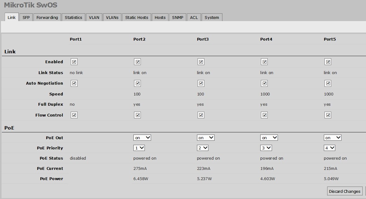

Most devices are RB912UAG-2HPnD. Most power consumption is between 4-6 watts.
Sometimes they falsely show .16 watts. I know this is false because the access point is working fine with a strong RF signal.
