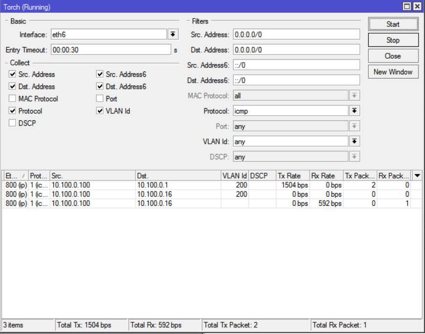

Hello i have problems with packet tagging on RB3011. I configured VLANs on both switch chips a set switch1-cpu and switch2-cpu port to secure mode and header add if missing.
Then I instantiate VLAN 200 interfaces on both master ports and bridget it together. In this configuration I observe significant packet loose between some clients in VLAN200 if traffic goes thru bridge.
After little peaking with torch tool I found that sometimes switch chip omit add vlan tag on cpu port if packet comes from access port (untaged) of switch. From trunk port (already tagged) it probably allways works (cpu gets packet with vlan). Also when device is on access and trunk port on same switch it works - so problem is only with tagging on cpu port.
I expected that when I set “add if missing” on cpu port then CPU sould not get untagged packet, but according to attached picture sometimes VLAN 200 is added and sometimes not.
Legend:
10.100.0.100 computer attached to ether5 (header always strip,mode secure,vlan 200) - used to send ping requests
10.100.0.16 device sttached to ether9 (header add if missing,mode secure)
10.100.0.1 RB3011 itself

I found also that packet lost depends on IP and/or MAC of client - I have 3 clients connected on eth9 via external switch and can communicate only with one from eth5 access port, but router itself see all clients. So definitely it is problem with traffic from access port that go thru CPU (bridge).
Also behavior changed slightly when SFP is inserted - but because it cannot be done when powered i don’t know if it is result of rebooting or change in internal topology due to SFP.
Update:
STP/RSTP is disabled on all bridges in test setup (I checked all connected devices)
router (cpu port) - access port communication not working correctly, exhibit same problems as access port to trunk port via bridge (probably I’ve luck in choosing IP/MAC for previous tests)
when SFP is inserted (just power off,insert,power on - no configuration change) then switch 2 communication looks like working correctly. Switch 1 still have some problems but in much less cases.

I have observed that too actually , this was my post with helpful picture http://forum.mikrotik.com/t/cant-ping-between-access-ports/107892/1
On this router shared Vlan between two switches is kind of magic. Sometimes reboot helps, sometimes assign static ip, then changing to new and reconnect device helping. It’s totally weird because RB2011 have two switches and no problems with shared vlans.
Mickey:
Maybe this is because RB3011 and RB2011 have different internal connection between CPU and switches (RB3011 have two links to each switch and RB2011 only one to each).
I don’t find any configuration of switch that works, so I have to bridge access ports to VLANs in CPU instead of switch (to get this working you have to set IVL on default CPU VLAN and bridged VLANs otherwise switch gets totally confused).
I suspect that problem is in internal bonding between two links to CPU - also symptoms look like if you have bonded interfaces and one link have significant error rate (this can also explain why behavior changes with IP addresses etc… - bonding engine choose path for packet by hashing packets header). Also my least experiments with SFP (inserting SPF disconnect one link from one switch) talks for this explanation of problem.
