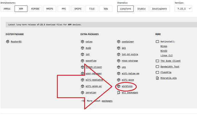

The logfiles tell me somthing about a missing wireless package, but I can't find such an package.
As you can see on this page you should use the arm and not arm64.
