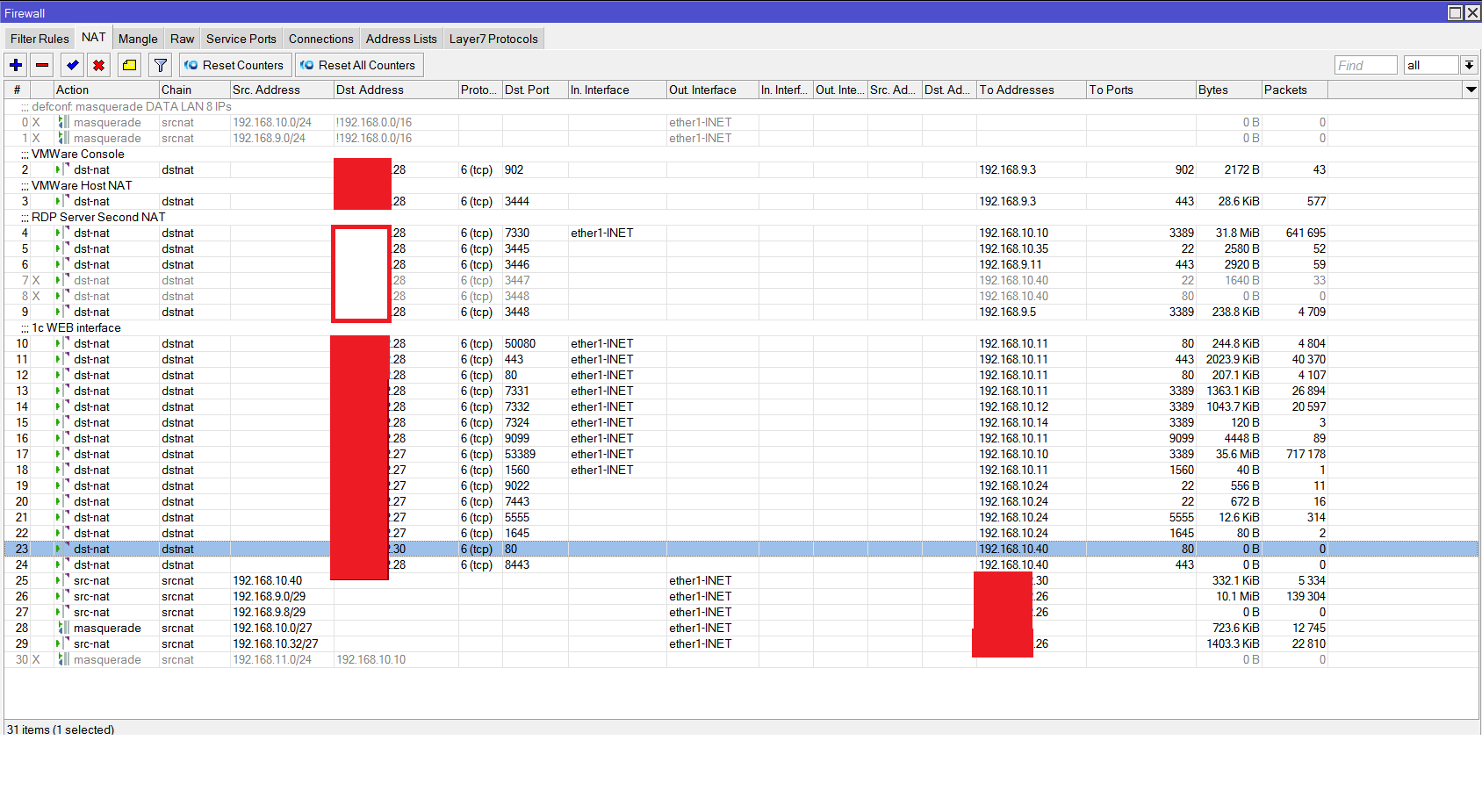

I created NAT to portforward 80 port to server. Add forward rule and try. Do not work. I checked log and found that router do not know where to send packet.
(log attached).
It strange cause when I try to download packages from internet it works. Why Mtik do not find MAC and out interface ?
I try to use old rule (rule 7,8) and that WORKS.
Now I am confused. Why it work?
