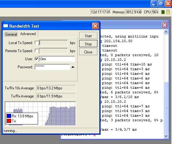

RB333-R52H only able to get 13.8Mbps

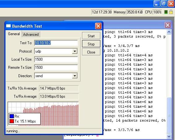

RB112-NMP8602 able to get 15.1Mbps

But here are the capture i made:
and
The winner is :laughing:

The problem is within the RB112. Look at it’s CPU occupation: it’s always at 100%, so RB333 can’t push more than 13Mbps on the other side (RB112), becouse the ā€œother sideā€ is at it’s limit. Try RB333+R52H with another RB333+R52H with the same distance/connector/antennas, and you will see higher throughput.
The strange thing is the CPU utilization on RB333: 56% is quite high@13Mbps, i expect max 20-25% of utilization IMHO.

But i’m still curious, because the test i did @ RB112 side only.
Tested by doing sending and receive.
CPU utilize @ RB112 always reach 100% all the time i did the test, i think it will be to hard to send packets to RB333 as much as 15.1Mbps right ?
:confused:
Mainly the sending part of bandwidth-test is the thing that consumes a lot of CPU power. So the poor little RB112 is more than at it’s limit with creating (!) that much traffic. The better test always is to run bandwidth test from high power machines (2 GHz CPU upwards) behind the routers creating the wireless link…
