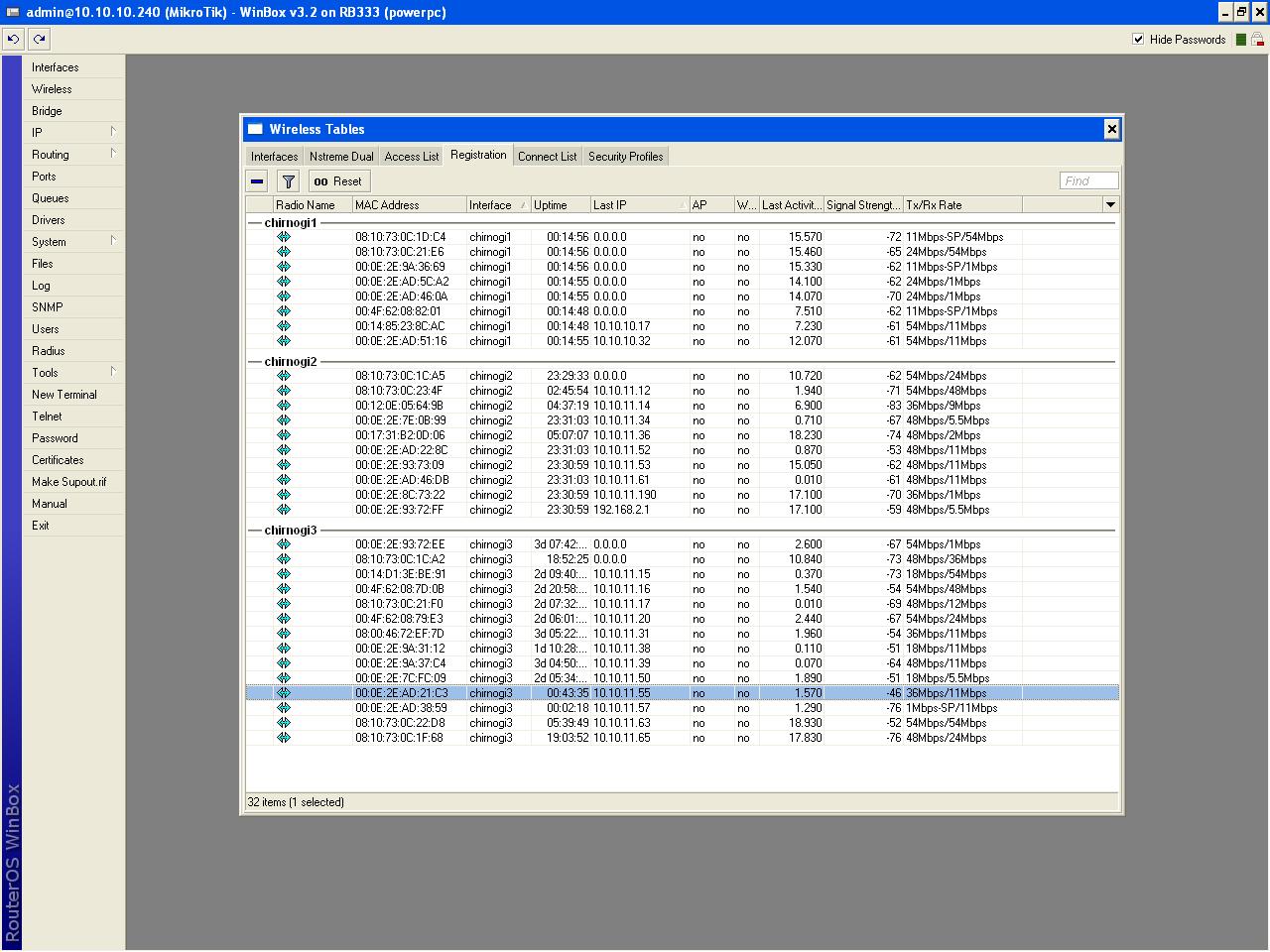

Good signal levels, but I have nasty pings, sometimes they are between 2-6 ms, but most of the time they go to 18-150-800 ms with no substantial reasons… no traffic, anything.
Does anyone have any idea?
I`ve tried changing the channels, the ack timeout, calibration, noise immunity, tx power… nothing seems to solve my problem.

Take a look at tx vs rx signal. you’re getting noise, a radio going out or a corroding connector.
Looks like the rx speeds are almost always lower, likely noise at the AP. The CPE’s get good signal, the AP gets poor. Tried different channel width?
