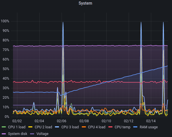

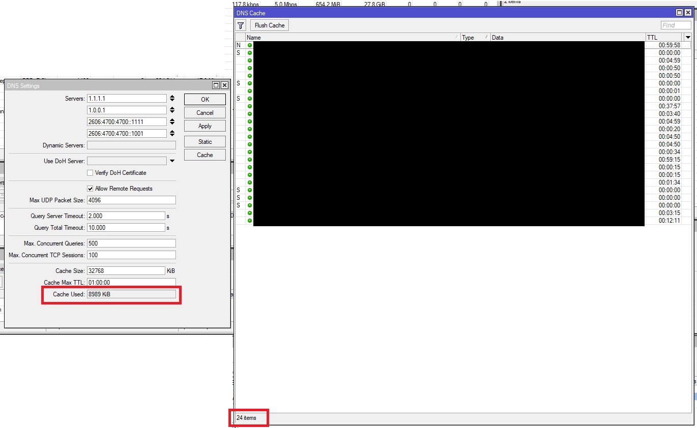

I noticed a memory leak in the DNS server in version 7.7 on my RB4011. Has already been reported to support, have not received an answer so far.
Maybe this is the cause of some crashes.

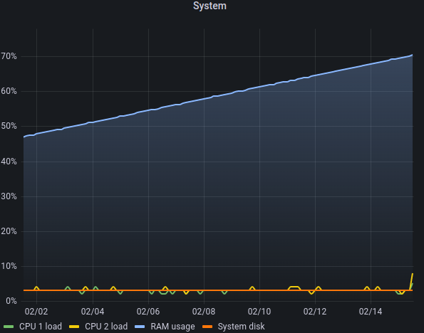

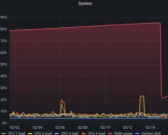

I noticed that on all mikrotik devices including CRS (where CPU doesn’t really do anything besides SNMP regularly). Also virtual machines on x86 have the same issue.

I have a memory leak also on multiple routers that run as Hotspot controllers. I have simplified the bridging down to the lowest point where it will still function and will see how it goes.
I went to 7.8 and the memory leaks seem to have stablised considerably. Not entirely convinced they are gone, but it is clear they are significantly improved.
Also noticed same on a hAP ac lite unit for which the upgrade to 7.8 completely fixed it.
7.8 has indeed resolved the issue. Although nothing in the changelogs to indicate this should be the case or if something was actually identified that I can find.
