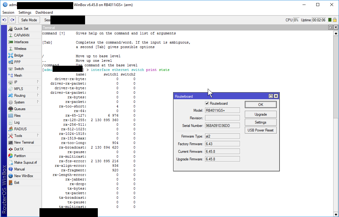

[admin@x] /interface ethernet switch> print stats
      driver-rx-byte:              0       0
    driver-rx-packet:              0       0
      driver-tx-byte:              0       0
    driver-tx-packet:              0       0
            rx-bytes:              0       0
           rx-packet:              5       0
        rx-too-short:              0       0
               rx-64:  2 130 907 700       0
           rx-65-127:              0       0
          rx-128-255:              0       0
          rx-256-511:              0       0
         rx-512-1023:              0       0
        rx-1024-1518:              0       0
         rx-1519-max:              0       0
         rx-too-long:            936       0
        rx-broadcast:            944       0
            rx-pause:     41 740 288       0
        rx-multicast:              0       0
        rx-fcs-error:              0       0
      rx-align-error:     41 740 288       0
         rx-fragment:            904       0
     rx-length-error:              0       0
           rx-jabber:  2 130 907 560       0
             rx-drop:              0       0
            tx-bytes:              0       0
           tx-packet:            920       0
        tx-broadcast:              0       0
            tx-pause:              0       0
        tx-multicast:              0       0
For my understanding, the RB4011 has the SFP+ directly connected to the cpu and not the switch..
I enabled ether1, and suddenly I have a lot more error there.
      driver-rx-byte:              0       0
      driver-tx-byte:              0       0
            rx-bytes:              0       0
           rx-packet:              5       0
        rx-too-short:  1 107 053 440       0
           rx-65-127:              0       0
          rx-128-255:              0       0
          rx-256-511:              0       0
         rx-512-1023:              0       0
        rx-1024-1518:              0       0
         rx-1519-max:              0       0
         rx-too-long:            936       0
        rx-broadcast:            944       0
            rx-pause:  1 167 253 504       0
        rx-multicast:  1 107 054 592       0
        rx-fcs-error:  1 103 788 244       0
      rx-align-error:  1 167 253 504       0
         rx-fragment:            904       0
             rx-drop:  1 103 787 704       0
            tx-bytes:              0       0
           tx-packet:            920       0
        tx-broadcast:  1 096 696 456       0
            tx-pause:  1 096 696 200       0
        tx-multicast:              0       0
I assume the counters are the 2.5 Gbit links to the switch chips…
But there is no traffic on the switches. Switch1 was never active, and switch2 is active but ether10 is never used (during the uptime)
I’m aware it’s running the 6.44.6 version, I will plan an upgrade of the both the ROS version and the firmware.
Anyone any thought on how to monitor the drops?

Nobody any clues? Am i the only one see this?
I have upgraded the ROS version to 6.45.8 and firmware to 6.44.6

After the reboot I see errors:
[admin@xxxx] /interface ethernet switch> print stats
      driver-rx-byte:              0       0
      driver-tx-byte:              0       0
            rx-bytes:              0       0
           rx-packet:              0       0
        rx-too-short:              4       0
               rx-64:        608 256       0
           rx-65-127:          6 976       0
          rx-128-255:  2 130 911 744       0
          rx-256-511:              0       0
         rx-512-1023:              0       0
        rx-1024-1518:              0       0
         rx-1519-max:              0       0
         rx-too-long:            904       0
        rx-broadcast:  2 130 911 004       0
            rx-pause:              0       0
        rx-multicast:            310       0
        rx-fcs-error:  2 130 911 600       0
      rx-align-error:            936       0
         rx-fragment:            920       0
           rx-jabber:              0       0
             rx-drop:              0       0
            tx-bytes:              0       0
           tx-packet:              0       0
        tx-broadcast:              0       0
            tx-pause:        608 256       0
        tx-multicast:              0       0
Still strange because there is nothing using switch1…
I will check for RX DROPS and TX PAUSE over the coming days on the SFP+ port.
Cheers,
Harry
Hi All,
After somedays:
No more TX Pause which makes sense because flowcontrol is disabeld, so this is solved.
Still RX Drops, well I did not expected the new version to be able to handle the traffic any better… But still the load is not high.
The switch stats still look bad. I upgraded the FW to 6.48.8, so it its full update to date.
Straight after a reboot:
I have no ports active on switch1, so I tried by activation one port and reboot again.
After the reboot all the numbers for switch 1 stay 0, as expected. So i guess i hit some kind of bug.
