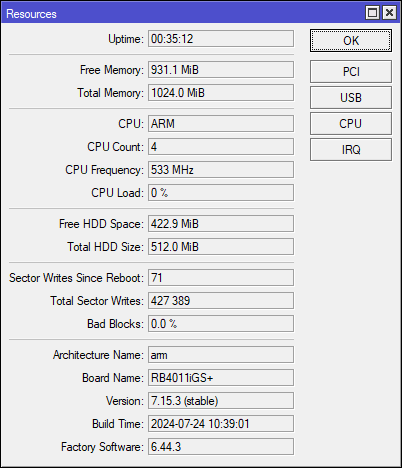

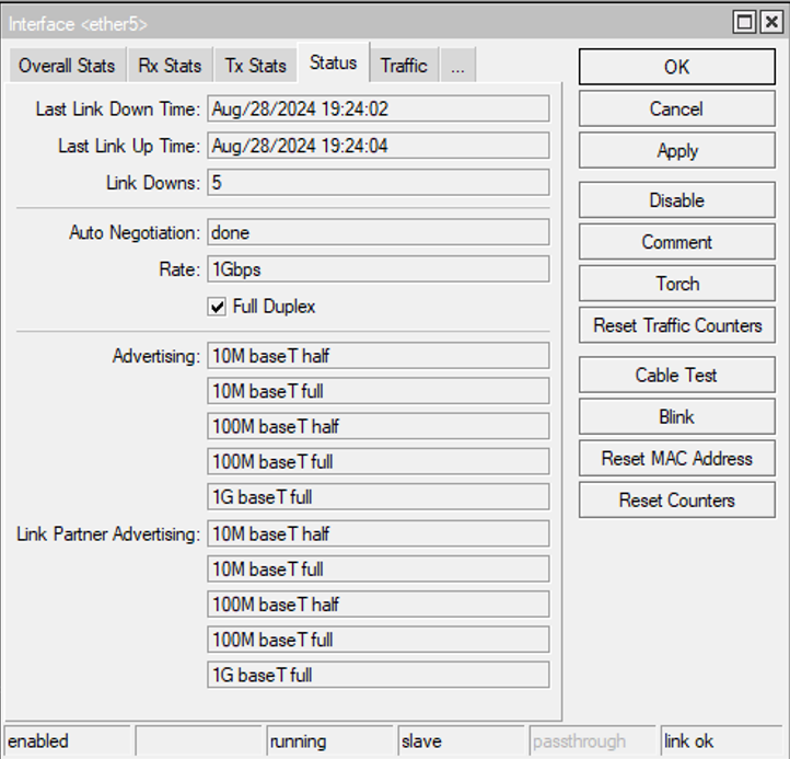

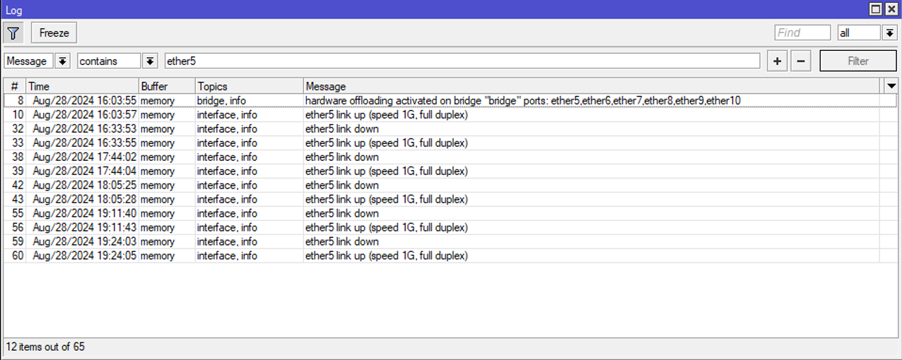

have RB4011 at home for about 3 years. Last days I found there is a problem with flapping ethernet 5 port.

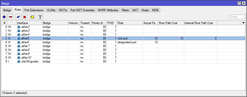

Ether5 is down for 2-3 seconds and back up at random times between 30-60 min. eth2-10 are in bridge
