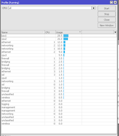

Check detailed resources information where CPU is spending time/cycles.

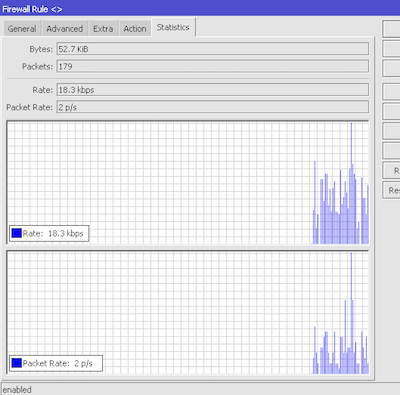

Something is definitely wrong, the fasttrack rule should be hitted only once per connection, after that it’s traffic should be fasttracked.
And something is preventing that.
The amount of actually fasttracked traffic can be seen in the special dummy rules located above.
Or you can open individual connections on the connections tab, and see statistics there.

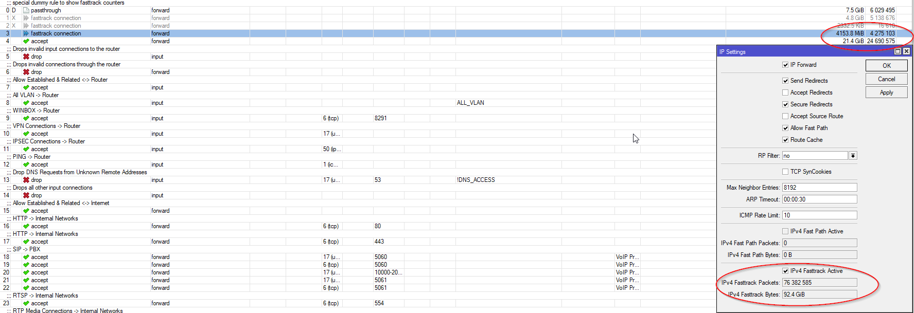

Fastpath is not enabled, does this have to be working for fastrack to work correctly? I have VLAN filtering enabled on the router. From what i was reading if vlan filtering is enabled fastpath is disabled. Packet counters increase exponentially in the firewall during the iperf test, however the packet counters do not increase accordingly under IP settings.

During the test the CPU is not unreasonably loaded:

This ↑ is probably your issue. FT rule should not count all the data:
Look at https://wiki.mikrotik.com/wiki/Manual:IP/Fasttrack#Initial_configuration - especially the part where you match the traffic. Maybe you can export the config with hide-sensitive?

as @xvo correctly stated, fastpath is a requirement for fasttrack… https://help.mikrotik.com/docs/display/ROS/Packet+Flow+in+RouterOS
fasttrack = fast path + connection tracking …
