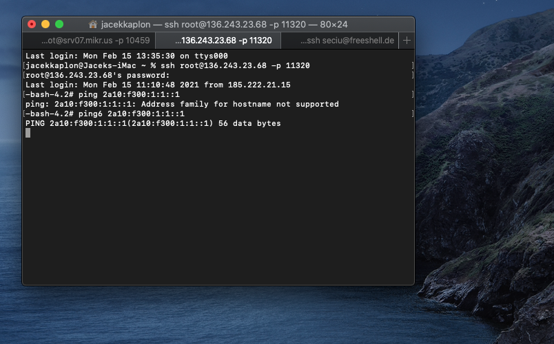

ping from outside see screenshot
Csn you ping router itself from internet? E.g. ping 2a10:f300:1:1::1? You’re pinging a LAN host which may have its own firewall blocking pings. It may have multiple IPv6 addresses in use and is not replying to pings on most of them …
You can verify addresses actually in use by router running /ipv6 address print .
For what it’s worth, my LAN windows PC often experiences issues with IPv6 (uses SLAAC for inventing IPv6 address) while my Linux server with IPv6 address statically set doesn’t have any problems. My WAN technology is PPPoE with DHCPv6 obtaining a prefix.

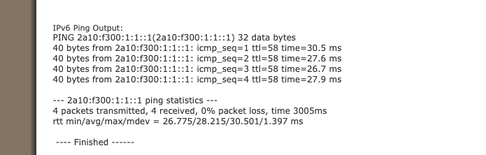

That’s the problem is. I can ping my router address 2a10:f300:1:1::1 thru some web pages - works https://www.subnetonline.com/pages/ipv6-network-tools/online-ipv6-ping.php see screenshot for the result. But if i try to ping on other websites or thru vps server its failed see the screenshot. Ive checked that on three different vps servers located in different countries with fully ipv6 support. 2a10:f300:1:1::1 that address i can ping thru my terminal on the computer and terminal windows in winbox - works. I just don’t have access to the world and from the world via ipv6. as you have seen on some pages works on others not. I have no idea whats is going on.

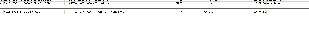

If you can access your router via IPv6 from some internet site, then IPv6 is fine between your ISP and your router. If at the same you can’t access (ping) LAN devices, then it’s most probably due to device’s own firewall. If you can access your router from some intetnet sites, but not from the other sites, then something is wrong from your ISP upstream snd the only thing you can do is to report problem to your ISP.
Another problem is that sometimes some pages don’t work while ping is fine … most of times that’s problem with broken PMTU discovery (and quite often that’s ISP problem) due to excessive blocking ICMPv6.
