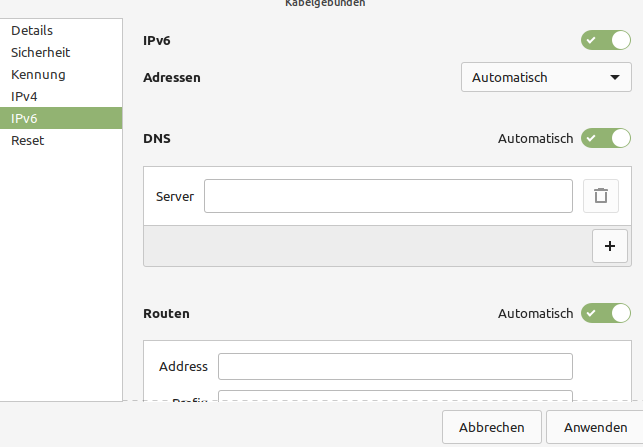

The problem: The PC is only getting a link local fe80 address. Somehow neither SLAAC nor DHCPv6 are working. Btw. also treid with Win10. Same result.

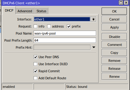

  • Create DHCPv6 Client on WAN interface with “Rapid Commit” and “Request prefix” checked) to get the prefix from my provider

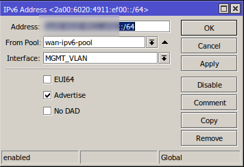

  • Assigned an IPv6 address to the VLAN (currently MGMT as my desktop is in that VLAN) and checked “Advertise”

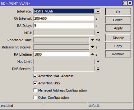

  • Activated Neighbor Discovery on VLAN

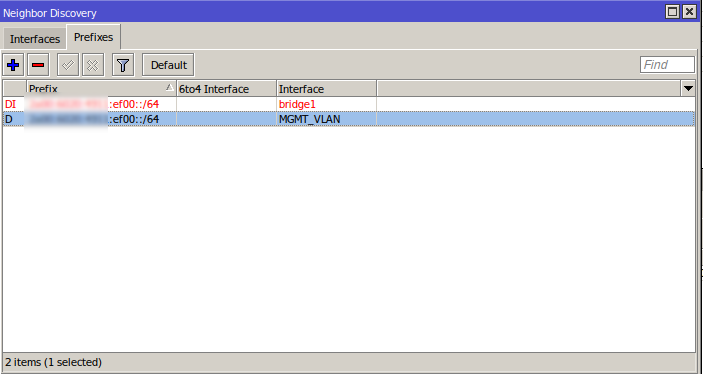

Strange thing: Neighbor Discovery Prefixes show an invalid entry for my bridge. Should I be worried?

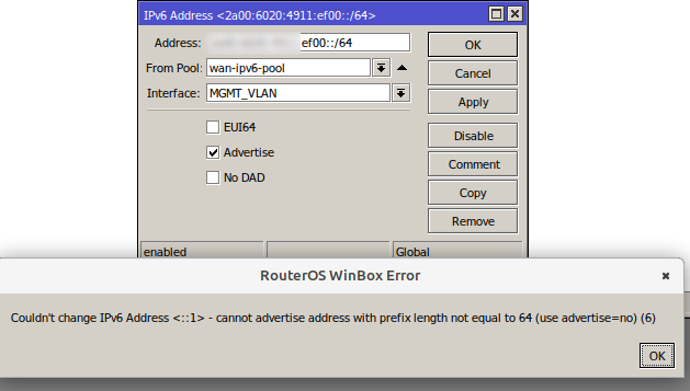

One more thing: Somehow setting ::1 as the IP address on the router made more sense to me. But that fails with the message that address with prefix length different from 64 can’t be advertised.

The DHCPv6 client should typically request both an address and prefix, unless the ISP is using one of the prefix addresses for the WAN.
If the ND entry is showing invalid something is wrong with the configuration. What size pool are you receiving? The subnet address should not be all zeros, this is a reserved address. You can use ::1, or similar, if you want a specific fixed address, otherwise use the EUI64 option to generate an address automatically from the interface MAC address.
Mikrotik only provide prefix delegation in their DHCPv6 server, it cannot assign addresses so you have to use SLAAC unless you have something else providing a DHCPv6 service for your LAN devices
Few things:
  • Prefix on bridge1 must come from somewhere, it has D flag, so it’s dynamic, probably from another address on bridge1.
  • You can use ::1, but you need to enter ::1/64.
  • You shouldn’t need public address on WAN, link-local is enough. And even if it wasn’t, it wouldn’t influence whether LAN devices get addresses or not.

to see if router tries to send something. Lower RA Interval in ND, so you don’t have to wait for too long to see it. Another way is packet sniffer on client to see what’s going on there.

The main difference seems to be where the IP address is assigned to.
After adding an EUI64 address on the MGMT_VLAN interface with Advertise checked the PCs received the prefix and got an IP. Pinging the router from the PCs is possible that way. But pinging external IPv6 addresses is not possible at all. Not from the router itself nor from any PC.
As soon as the interface which the IP is assigned to is switched from MGMT_VLAN to WAN(aka ether1) is is possible to ping external IP addresses from the router itself. But then the PCs don’t get a global IP anymore.
Btw: The invalid something message in Neighbor Discovery Prefixes was displayed because the IP with “Advertise” checked on was assigned to ether1(WAN). That is probably not a good idea. It disappears as soon as Advertise is deactivated or the interface is switched to the MGMT_VLAN.

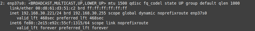

The PC’s NIC has
inet6 fe80:> :2e15:> e92c:55cf:1315/64 scope link noprefixroute
valid_lft forever preferred_lft forever
When trying to ping Mikrotik’s LLA from the PC the result is “The argument is invalid”

No. The PC uses a GUA as the source address, the packet is sent to fe80::de2c:6eff:fe18:caa through the enp37s0 interface (from default via fe80::de2c:6eff:fe18:caa dev enp37s0).
A device can have many GUAs, and especially when privacy extensions are used - with EUI-64 addresses formed from a MAC address you have the possibility to track that MAC address. Devices can generate multiple temporary addresses for outbound connections to overcome this.

Link-local addresses are not unique, they have to be qualified with the interface. As an analogy if you had several appartment blocks then saying ‘deliver this to number 7’ is impossible,you have to say ‘deliver this to number 7 in block X’. So
ping -6 fe80::de2c:6eff:fe18:caa%enp37s0
and
ping -6 fe80::de2c:6eff:fe18:caa%enp37s0.99
will send packets out of different interfaces.
Ah thanks for the clarification. Pinging the fe80 with %enp37s0 is working as expected.

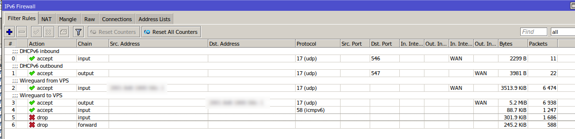

The drop rules of the IPv6 firewall have a log. I don’t see any logs of the drop rule while pinging.

If all you have in forward chain (which is where packets passing through router go) is single drop rule, then guess where packets from PC to internet go… or better not go. :slight_smile:
Oh man sure..I didn’t have a log on the forward drop rule. After adding accept to forward between MGMT_VLAN and WAN pinging the external system is working.
