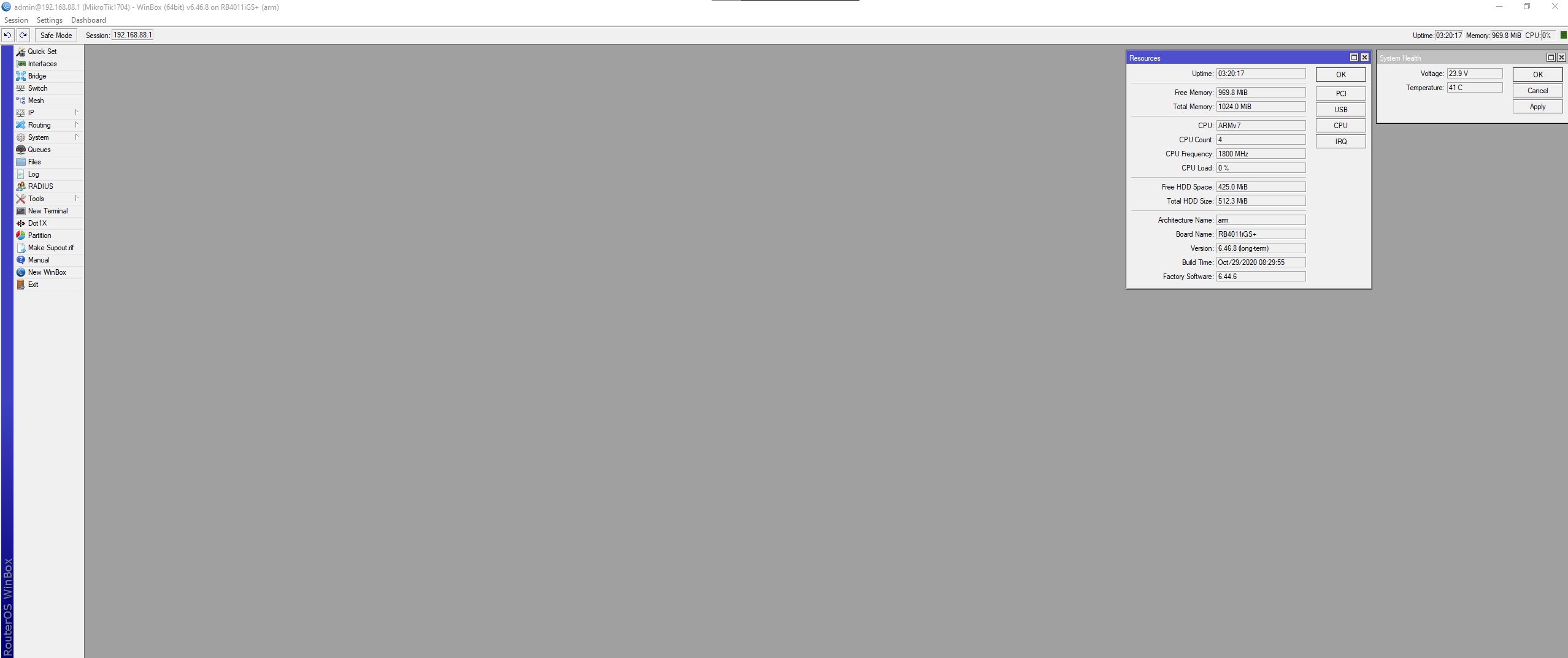

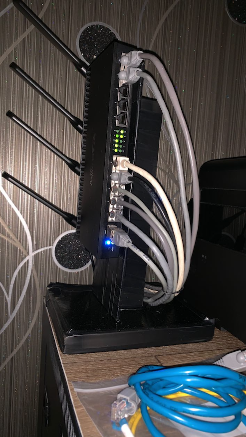

My RB4011 is in an upright position, which gives it more ventilation. It was a very hot summer in my region - +50 in the shade.
The temperature of the router did not rise above +44.
Really? Your RB4011 was cooler than the ambient temperature in the room? This can’t be correct data.
What was your actual room temperature (with conditioner maybe?) where the RB4011 was standing?

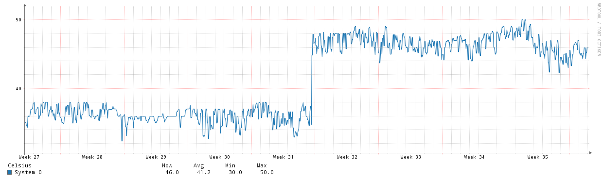

Here’s a comparison between RB3011 and and RB4011 that replaced it around a month ago.

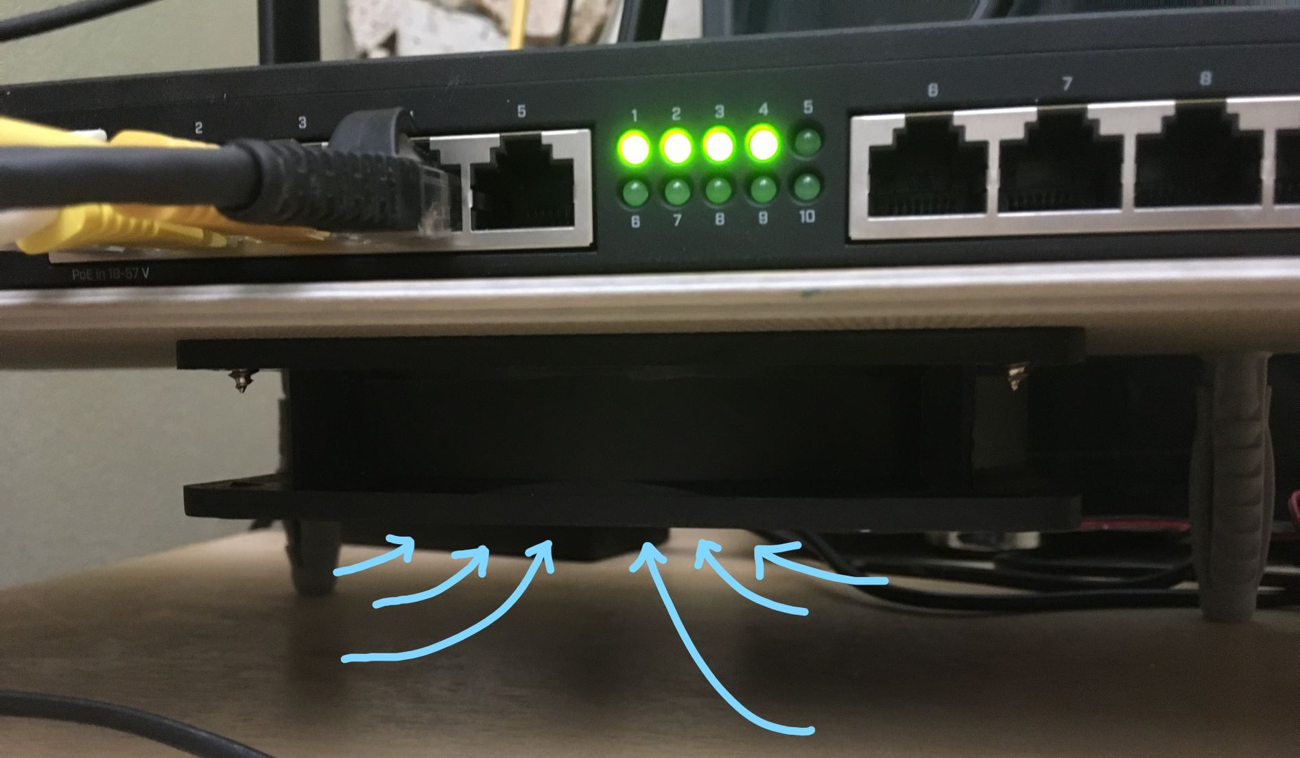

Hi Guys, I’ve a RB4011iGS (Wifi version) and IMHO the router is intended to be in a rack with ventialtion and Air conditioner so that’s the ideal I think, in my country now is summer and without ventilation and air conditioner it was running like 45° Celcius, I’ve made a cooler base (at my own) with some stuff that I’ve, and I’ve managed to decrease around 15°C now is working around 30°C without Air Conditioner On, when I do that is working around 26°C so in my opinion, is not prepared to work without external cooling and I think that at the end, it will affect the life of the router.
Here’s a picture of how it looks, just with a single cooler you can increase the performance and router life:
Here’s the temp with the cooler base and air conditioner on:
