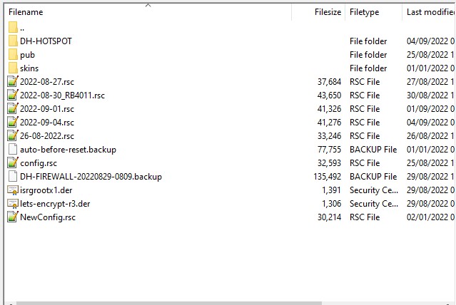

Although I think I understand the responses, I’m still confused. If I connect to the FTP on the router box (which I now managed to get working, was my own stupidity that wasn’t), I see the following:
The folder “DH-HOTSPOT” is my attempt to copy the files from my RB760iGS system (the HexS) to the bigger device (the RB4011iGS)… and apart from that, there are the bits and pieces for the certificate which we applied to the device, and some config backups that I’ve made as I was building the device up.
What really confuses me at the moment is that, whether there is some sort of historical link to some legacy file structure or not, the default files for the hotspot have got to be somewhere… and they don’t appear to be on whatever storage is being accessed by either the FILES widget in Winbox or via FTP (which is clearly the same thing).

Inside the DH-HOTSPOT folder is basically a copy of the hotspot files from my HexS box, plus a the files for bootstrap framework (I can send a screenshot if that helps)
I’m surprised the hotspot works at all as that configuration points to a folder which doesn’t exist, given what you have posted it should have html-directory=DH-HOTSPOT for the hotspot server to use your uploaded files.
