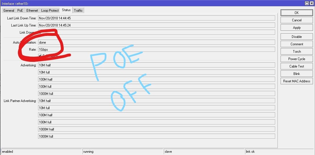

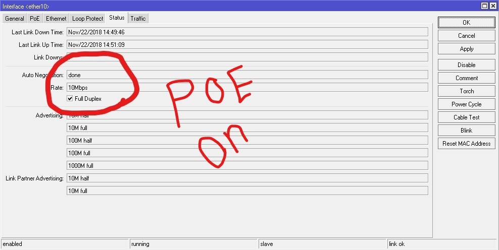

I’ve just got my first RB4011 and it works fine except the port 10 which is POE port, wich give the rate of 10Mbps with POE
any idea..
