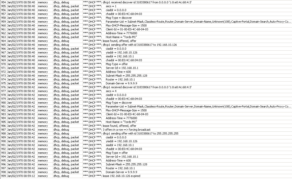

I’m trying to “upgrade” from RB450Gx4 to RM 4011iGS+. I thought it was just smaller adaptions to the config, since more ports, but what a misstake. I just can’t pass getting the clients an IP address. So I followed I don’t know how many tutorials in this forum, but always the same results, DHCP offering lease without success. The RB450 got a switch I understand that can set VLAN ID on port level, the one in RB4011 can’t (V6.x got some VLAN on RB4011 switch, V7 don’t)
So I started small with below. Log output attached

My RB450Gx ha been working great, I just needed more ports (and performance I thought). Now I’ve spent I don’t know how many hours thinking, it just a stupid mistake, you find it. Now I’m desperate and asking for help here.
Cheers, Tord
PS: I’ve tried different LAN cables, different clients, same same
