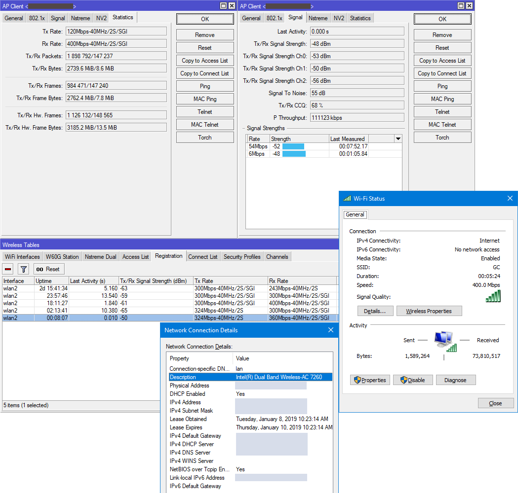

@mistry7,
Would you please make or acquire the data from the following screenshot?
This shows the Intel AC-7260 on a ThinkPad X220. The AP was the hAP AC, v6.42.10. Windows 10 1703 system.

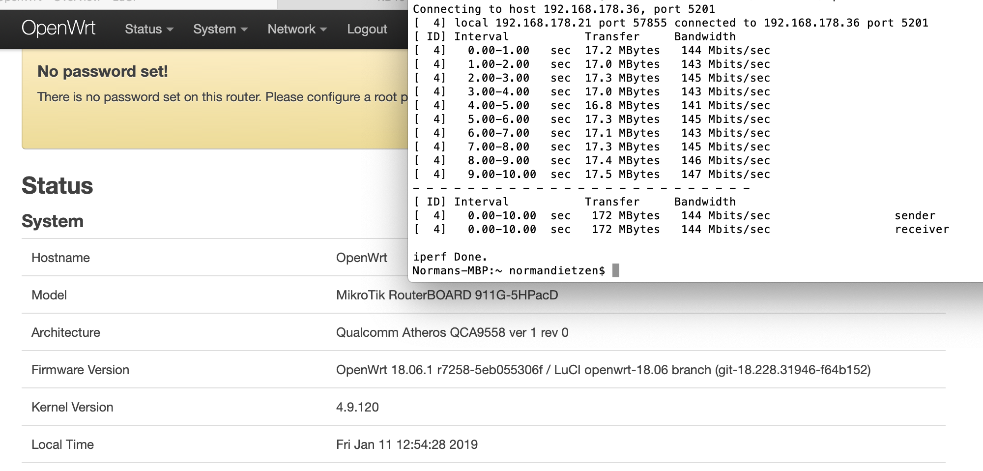

No WAP ac in Stock so i used 911G-5HPacD with OpenWRT and “new” CAP ac
  • Same Channel 5180 (channel 99% Clean, after 10min Scan i see neighbors network with -88)
  • 40 Mhz
  • ac only
  • WPA2-AES
  • Bridged setup
  • Same Distance (OpenWrt Shows -47 / Cap AC (ROS 6.44.Beta54) shows -55)
  • Same Macbook

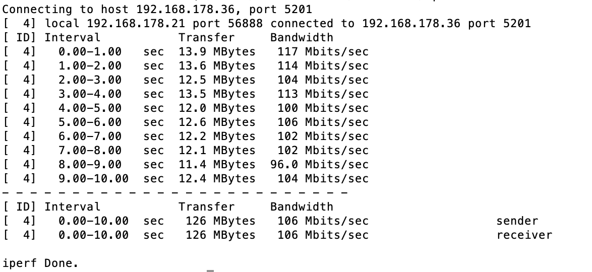

Open WRT:
CAPac:
If i have time later, i will flash Rb911 Back to ROS and Test with Ros

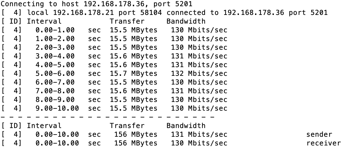

Here Macbook to RB4011 same Setup as above
MacBook has 3 Chain, and RB4011 (Registred tab shows: 540Mbps-40MHz/3S) does not benefit
An old RB911 Outperform newer Wave2 Hardware… or more possible bad driver
