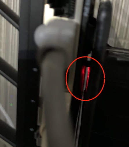

after a wlan1 failure, a red diode is lit on the inside of the device.
I found a solution!
i hade wlan1 was always in the bridge. If wlan1 is removed from the bridge, then it stops falling, and the red diode goes out.
In the case of CAPSMAN, I installed a datapach for wlan1 without Local Forwarding, and it also stopped falling, and the red diode is off.
