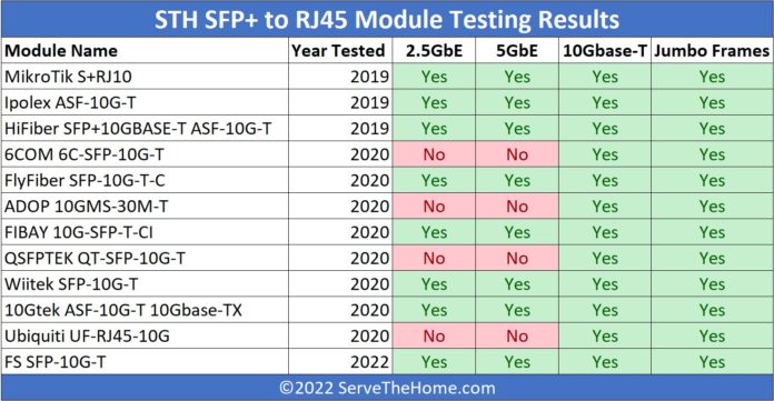

Ubiquiti UF-RJ45-10G SFP+ to 10Gbase-T Module cannot do 2.5gbps
But Mikroitk S+RJ10 should be able to do that.. ,
https://www.servethehome.com/sfp-to-10gbase-t-adapter-module-buyers-guide/
ok, thanks for the table
I had tried the Ubiquiti UACC-CM-RJ45-MG, the 6COM 6C-SFP-10G-T I had tried it and in fact it didn’t work at 2.5Gbps
I also have a 10Gtek ASF-10G2-T and HiFiber ASF-10G-T to try as well

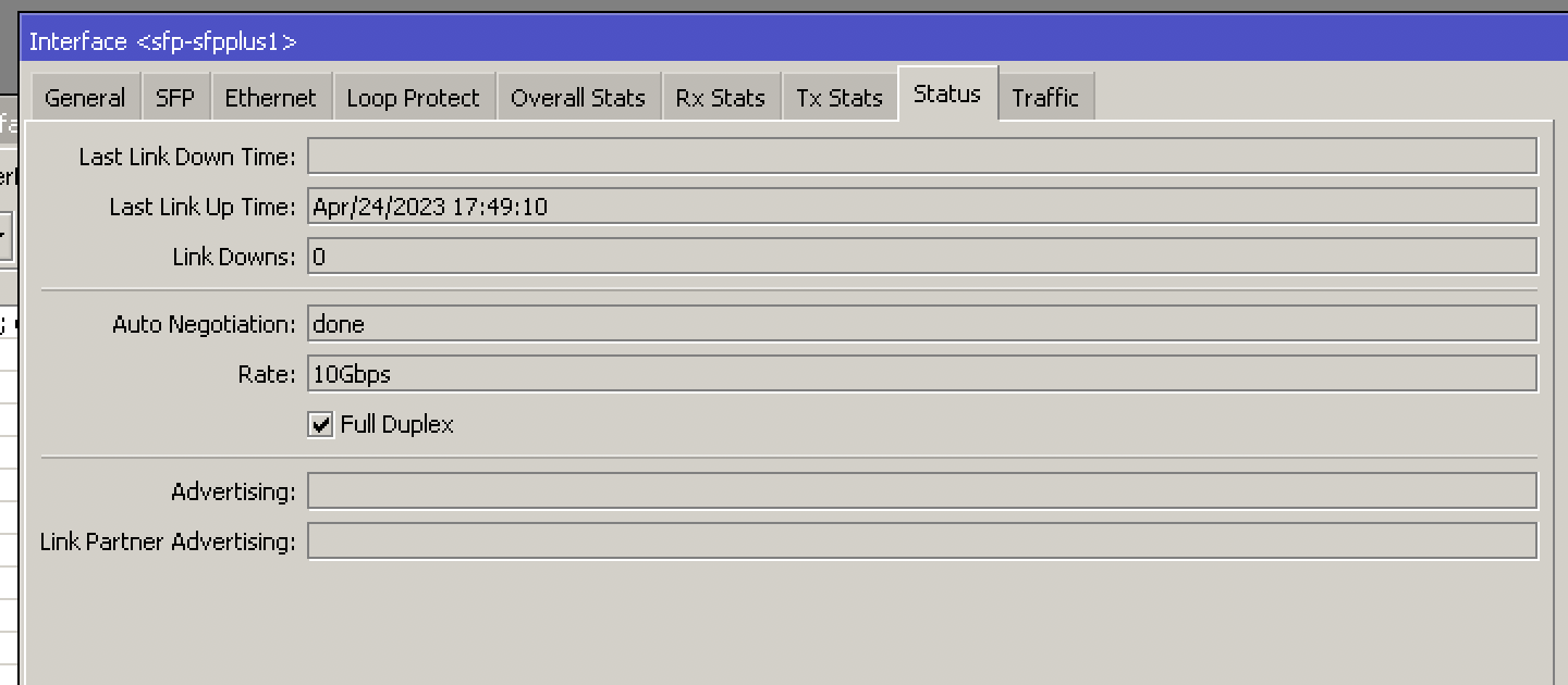

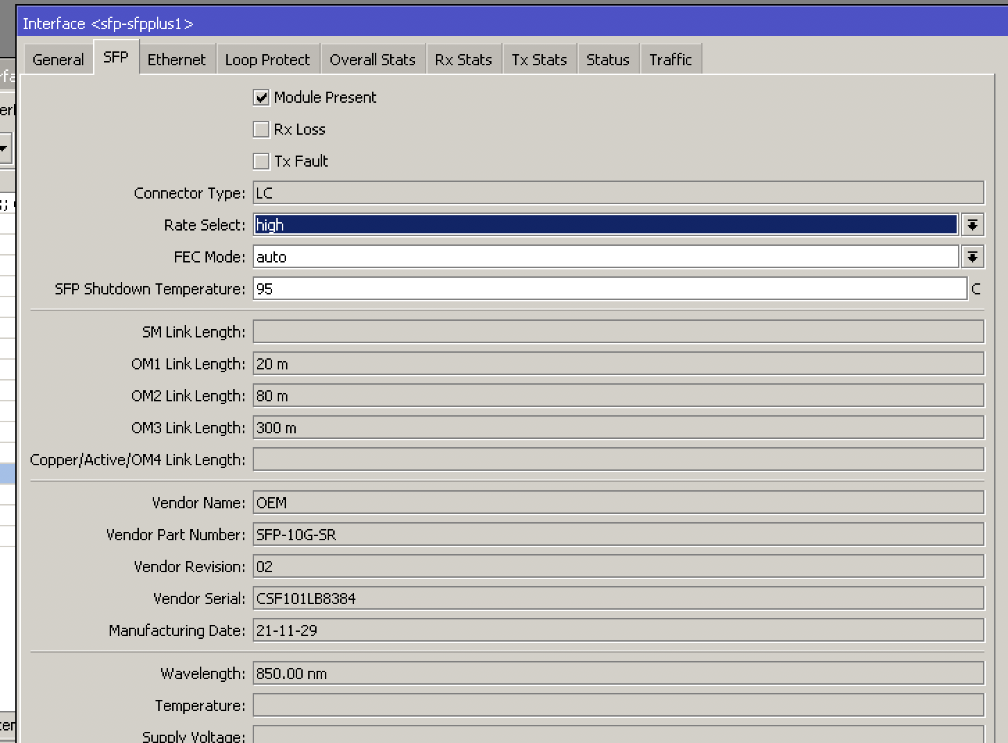

Solved
