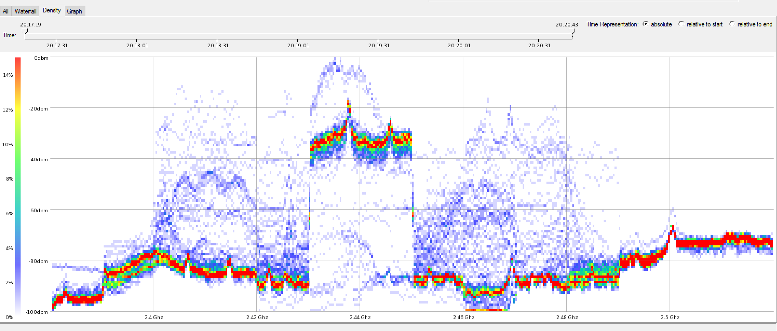

I started a spectral scan and noticed a very strong signal in part of the spectrum.
Signal persists even after moving the router to a different room

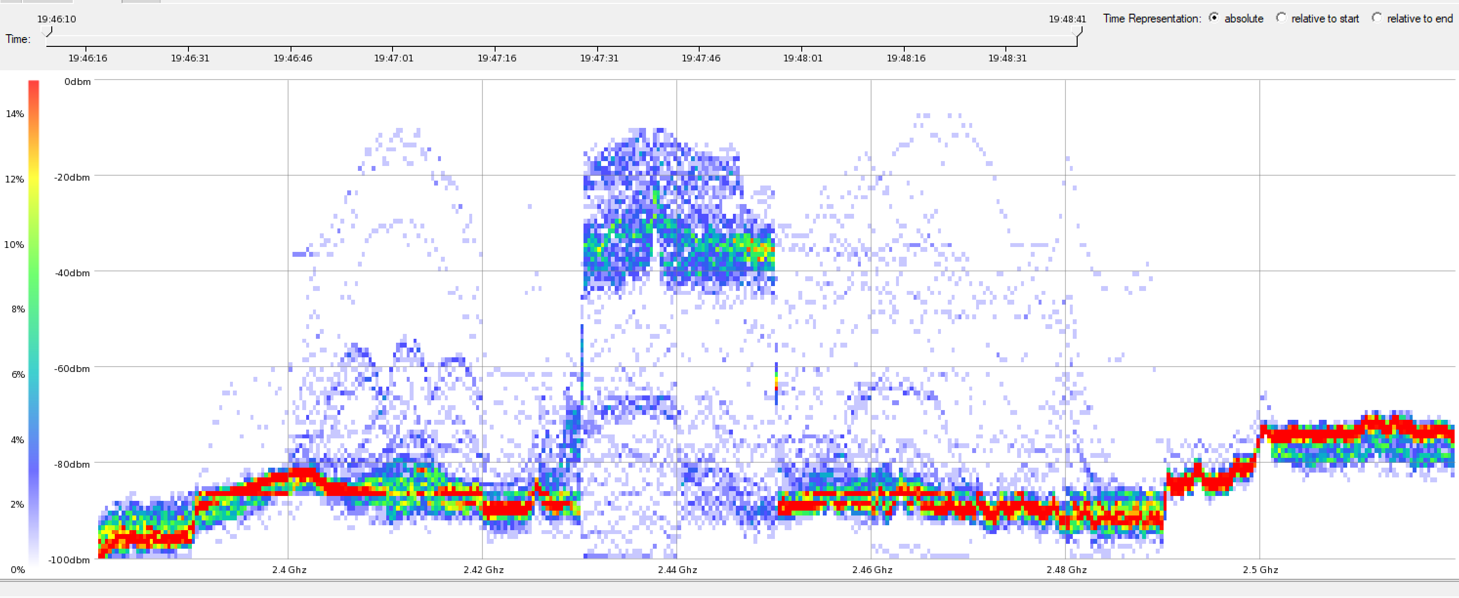

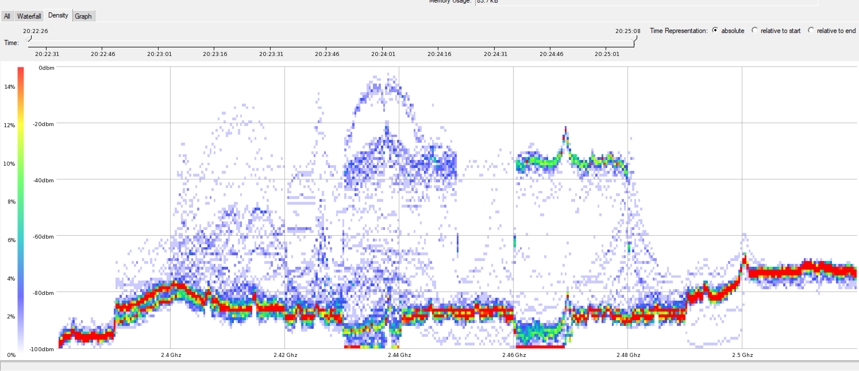

Tilting the antennas left reveils a second strong signal

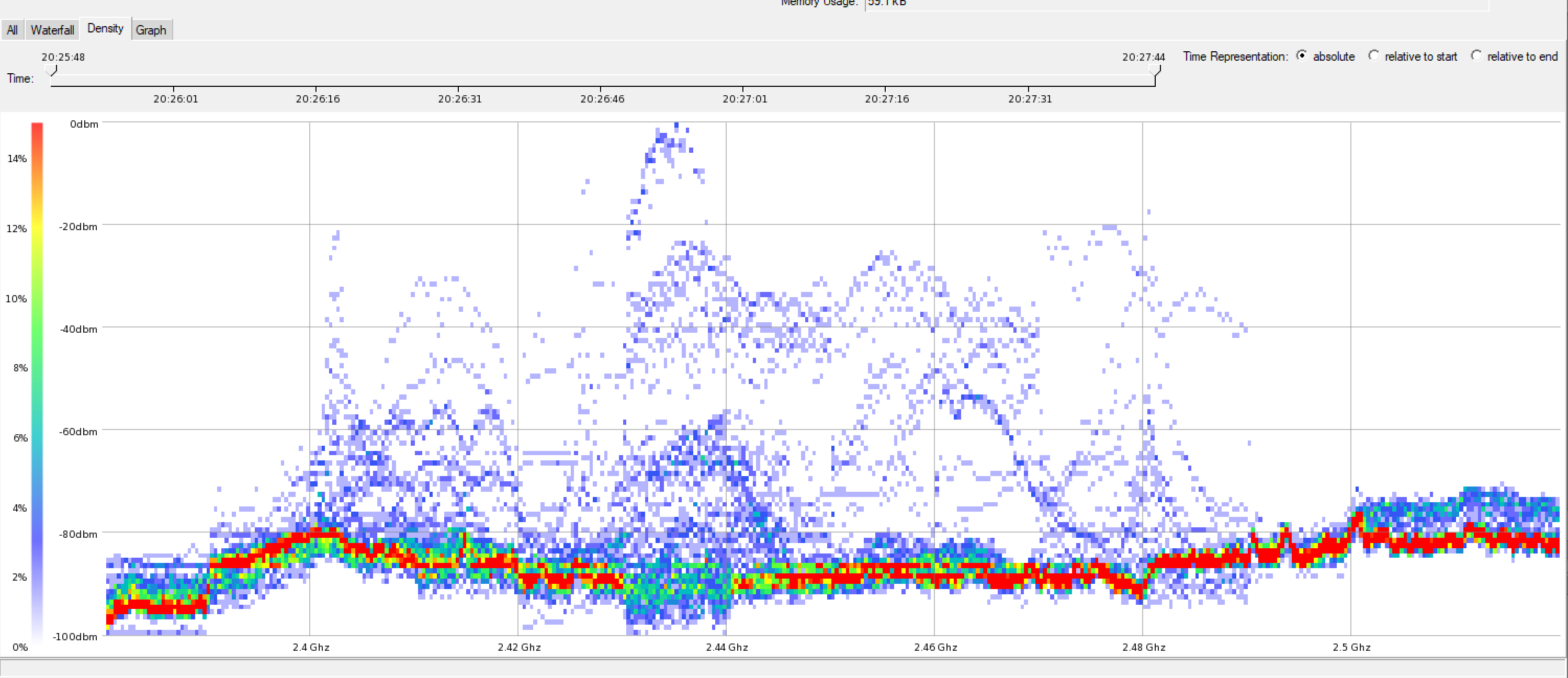

Tilting the antennas right both signals almost disappear

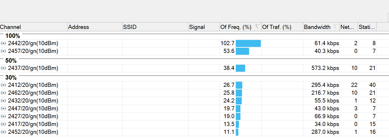

Snooper shows the following

It seems like an external signal. When you compared spectral scan results in different rooms the signal was there, but a bit weaker, but that also reflects on almost the whole of the spectrum. Adjusting the antenna position did make that signal bit weaker, along with the second signal, but that also goes for most of the other signals.

An unexpected update: the mysterious signal disappears when I disconnect the SFP module from the router.
