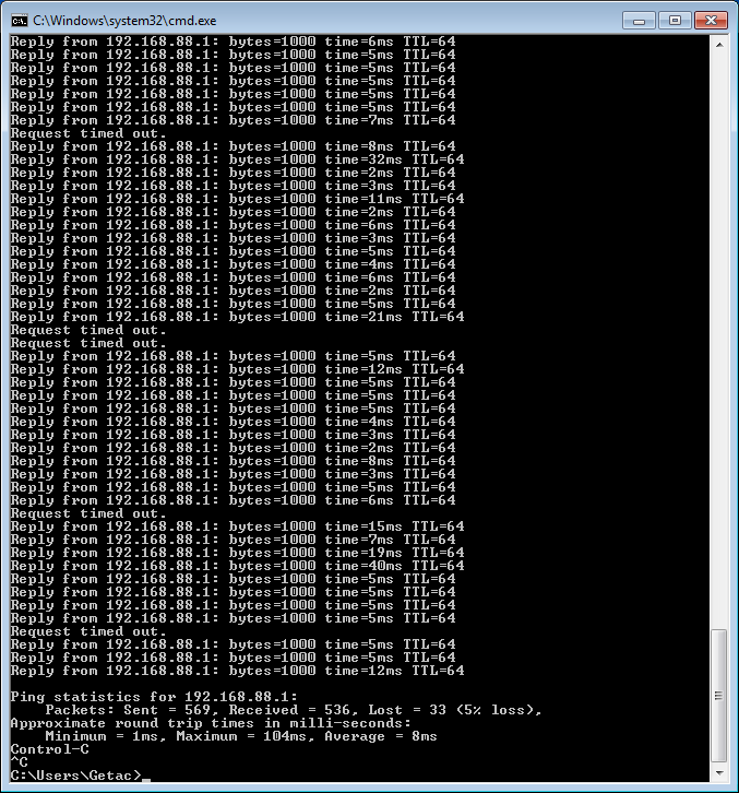

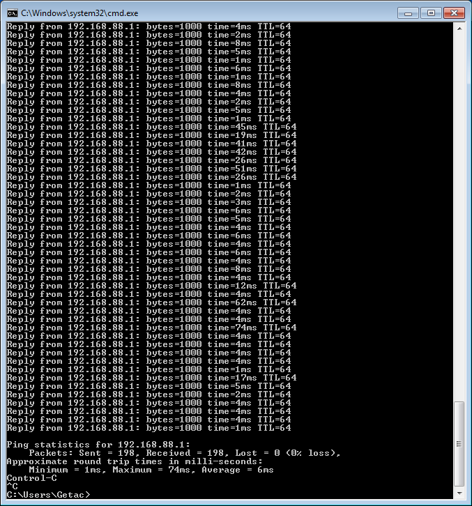

I tried to use wifi interfaces without cap configuration, and it’s a lot better, but not perfect.
Wi-Fi not restarting anymore (http://forum.mikrotik.com/t/rb4011-wlan1-disabling-itself/125605/263), but 5GHz drops packets (around 5% of them). 2.4GHz is ok.

Packets drop for 5GHz is still present (around 5% of them). Do you have any ideas?
UPDATE:
I removed Frame-Lifetime value (setting to default) and there is no packet loss.
