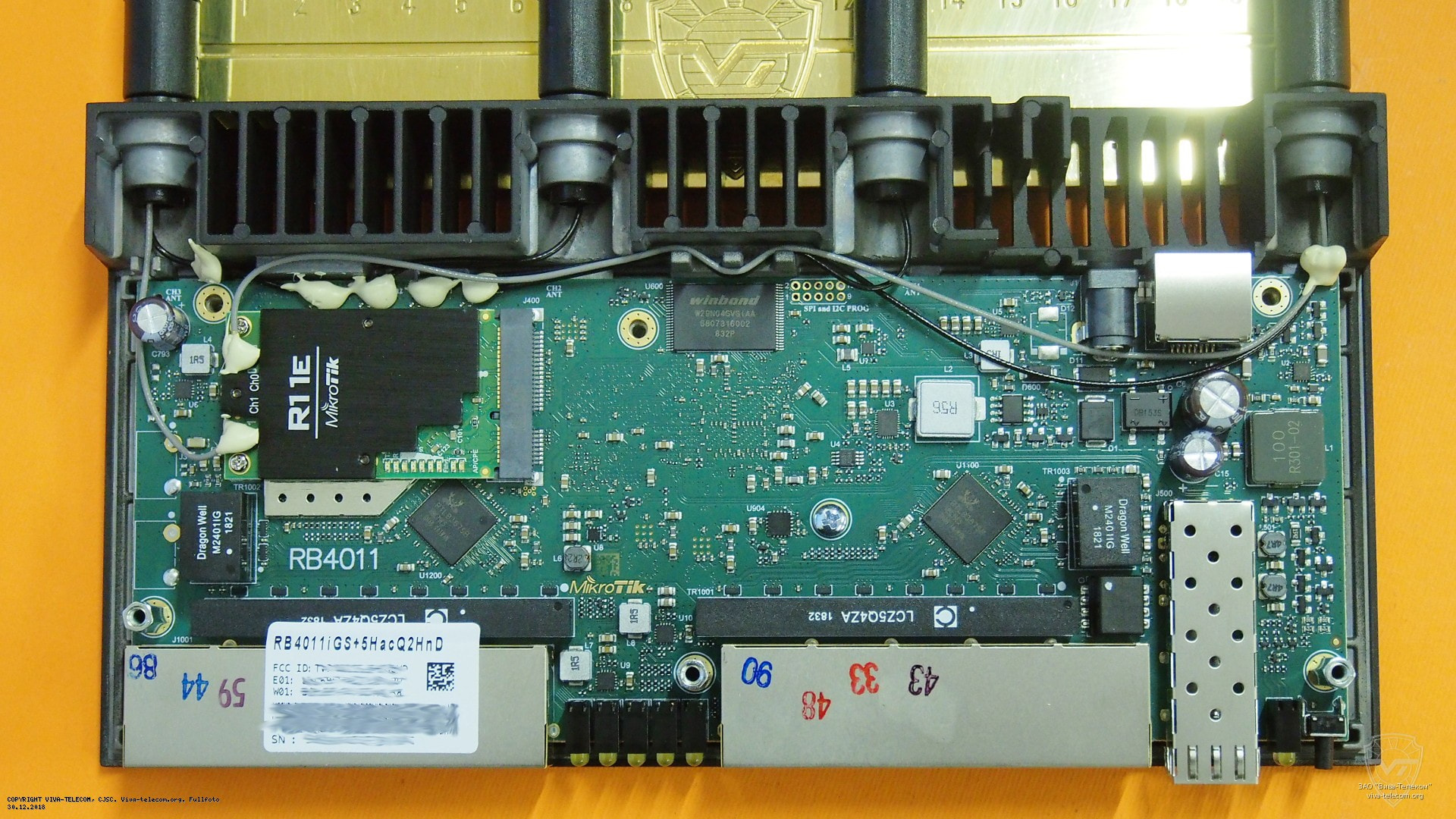

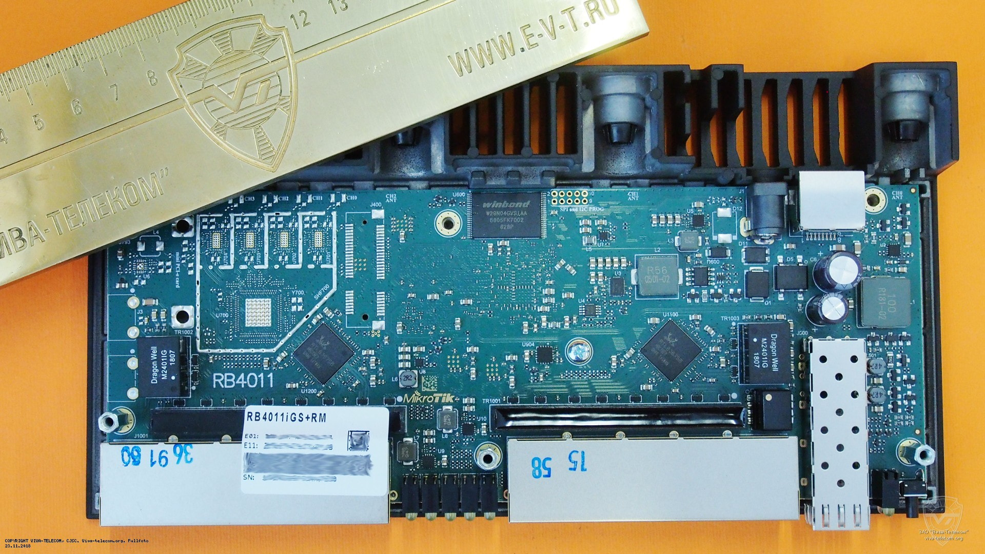

Based on my old post, if I remove the wifi chip from the 4011 with wifi, would it support 70 degrees? In the place where it is installed it doesn't reach 40, however I don't use wifi and if lowering its temperature would allow me to do that!
RB4011iGS+5HacQ2HnD-IN Tested ambient temperature -40°C to 45°C
RB4011iGS+RM Tested ambient temperature -40°C to 70°C
Only the 2.4GHz module can be (easily) removed, since it's a module.
The 5GHz chip and it's amplifiers are soldered on the mainboard as you can see for yourself, while it might be possible to cut only power to it, it might have undesired effects.

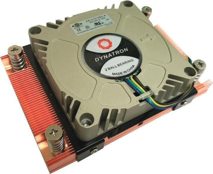

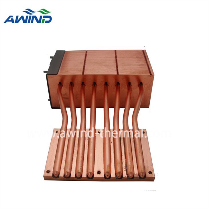

Just POC ideas:
  • remove any WiFi removable elements, do not desolder anything.
  • try to mount used cheap laptop radiator like this one - two pads that may cover/reach both RTL chips
  • try to power the fan to help the air move across the internals
  • as bottom of chassis is a radiator for the CPU, you can try to extend it with bigger copper element attaching it to outer surface
  • or like that
  • invest into monster like that, if only it fits inside or as an external active bottom additional radiator
  • try to install through holes in the chassis th heat pipes + radiators
Each solution is in a DIY style and brings equal amounts of satisfaction and frustration. :slight_smile:
