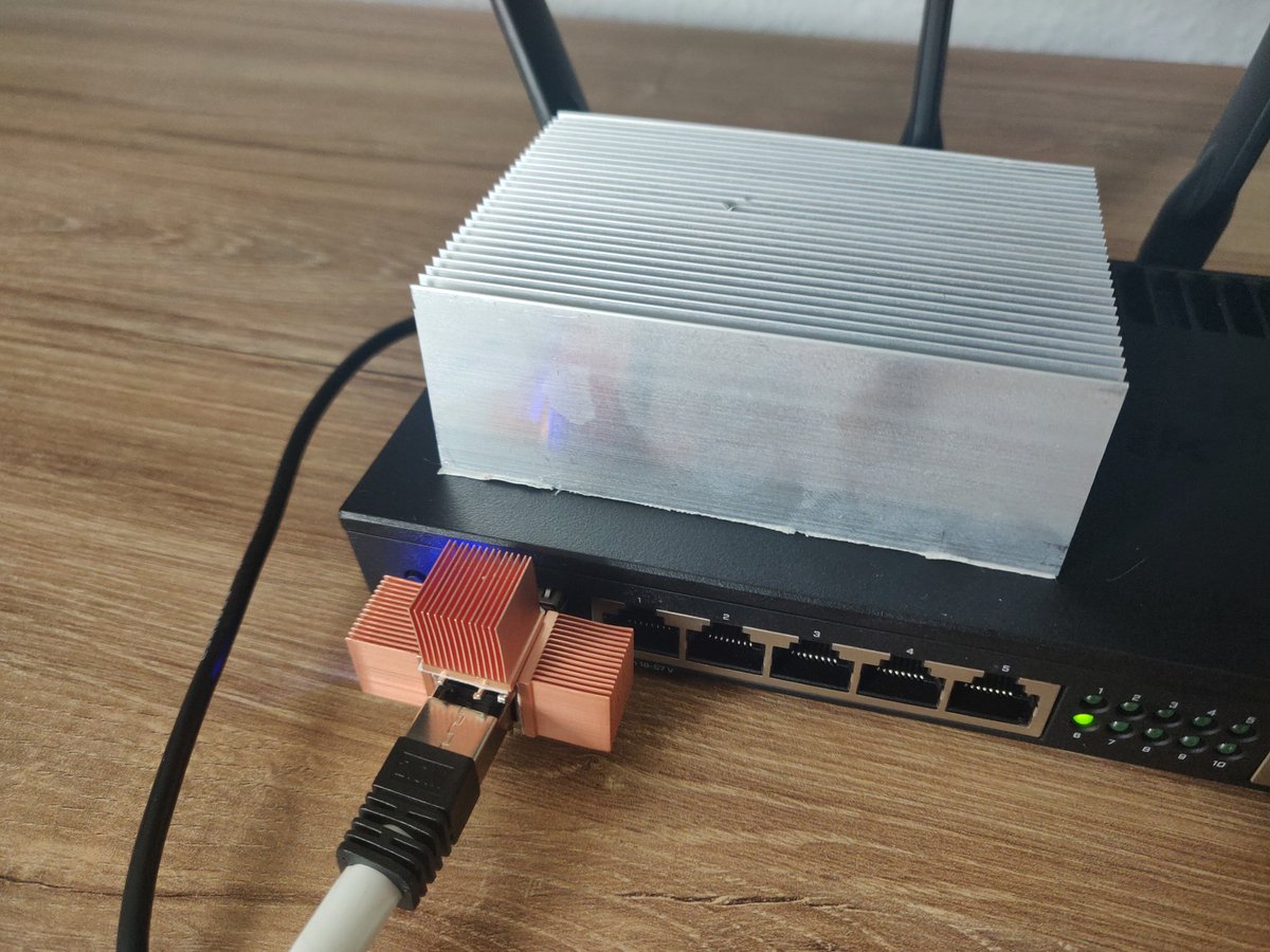

How could i add extra cooling in my RB?
The colling should be applied to RB
or on the outer casing of the S+RJ10 (like this: https://pbs.twimg.com/media/EfnwlxKXoAAGyfV.jpg)?

The S+RJ10 will get super hot (not the RB, that will stay the same). Especially if there is no forced airflow over S+RJ10 it can reach 90 degrees C… it’s pretty bad.
is a very bad idea to match s+rj10 with a rb4011 or rb5009 compact passive cooled devices
even worst on wifi version of 4011
s+rj10 gets very hot and it will transfer heat to the rb4011, maybe temperatures on rb4011 not rise so much but s+rj10 maybe gets hot beyond reliable operation, maybe internal components close to sfp cage will get very hot too without notice.
if i was you i will put a fan in front of sfp cage in that scenario, aditional heatsinks for s+rj10 i think can help a lot but can be cumbersome
