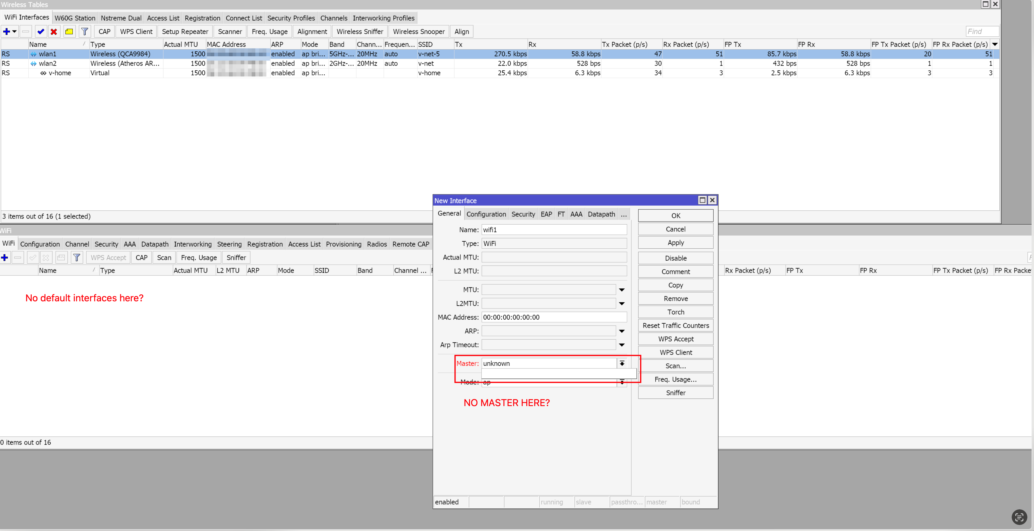

RB4011iGS+5HacQ2HnD setup with cAP AX
I have RB4011iGS+5HacQ2HnD for some time running without any issues. Current version of RouterOS is 7.14.2.
Now I want to extend the network because it’s not good at some places. I’ve bought cAP AX without previous investigation about setup what was probably wrong :-/
I’d like to setup capsman, but I’ve seen that there are 2 versions. When I look into new one I don’t see any interfaces which is suspicious to me. Is that ok? Would it be possible to run RB4011 as capsman server even for cAP AX?
If capsman isn’t the right way to go, what would be the easiest way to have the same SID(s) on both APs?
I’ve read through many articles but it’s little bit confusing for me.

Hi and thanks for response.
Eventually I did it with capsman, the only thing I needed to do upfront was to login to cAP AX and upgrade firmware to the same version (7.14.2) after that capsman started to work.
