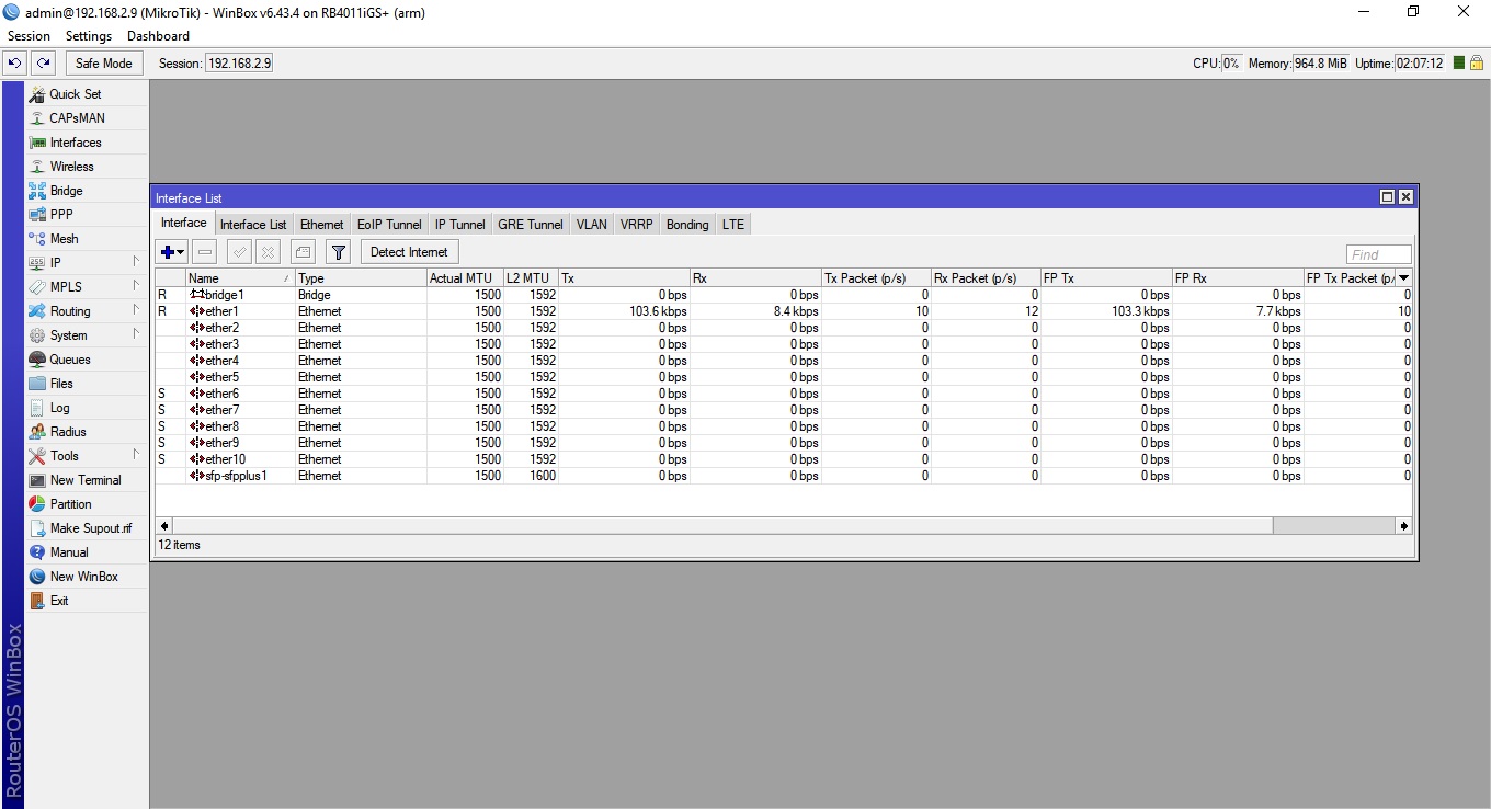

RB4011iGS+RM no switch settings?
I just got the RB4011iGS+RM and there are no switch settings on the WinBOX or on webfig. I have tried to upgrade to the new 6.43.4 version and downgrade it to 6.43.3 and install 6.43.4 via netinstall. No luck. I have a RB1100 that uses the same CPU and switch chips. The switch settings are there.

The switch tab is missing

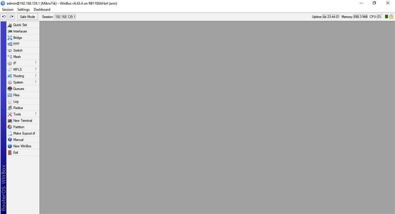

This is RB1100. The switch tab is there
Yes, I know. In my rb4011 is switch menu also missing. Why do you need this menu? Switch chip in rb4011 is only for switching and mirroring. It is possbile configure via winbox…
On rb1100AHx4 - what is inside switch menu? You can in rb1100AHx4 configure VLAN in switch menu?
