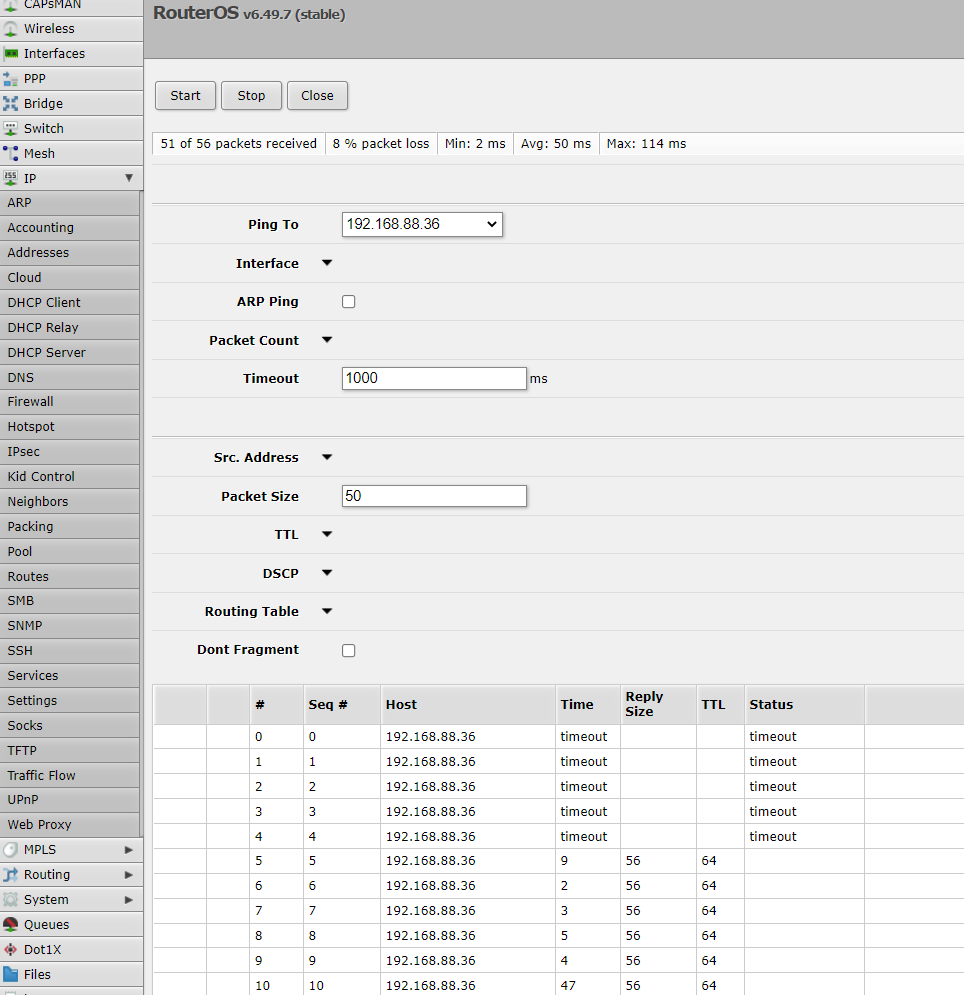

One more information. When the Internet is freezed on iPhone:
  • it is not possible to ping the device from router (see attachment)
  • after few seconds it’s normal again
During this time phone can reach other devices in the same network (amplifier) and also router (page with login/pass is opened).
No idea.. what should I check next?
And still → it’s not one iphone: both devices have the same issue.
