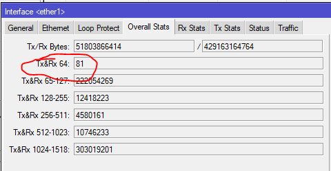

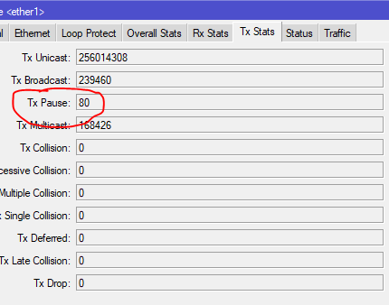

The only one interesting issue I’ve found is that even if its maxed out at 20% cpu usage… I’ve found that in Tx stats of the eth1/wan portI get Tx Pauses - and interesting correlation is that it happens almost at same rate as Tx&Rx 64 size frames.
Yesterday it was 64 vs 63 TxPause
today its
81 vs 80…
Its almost nothing.. i know but it might be indicative of some bug.

If anything, high CPU usage could cause to miss transmitting a pause frame, not increase them.
The correlation between the small frame sizes and counts is probably correct as pause frames are generally small.
Cha0s mentored this is how flow control works. The numbers are not that high, but if you don’t like it, just disable it on your devices (routers and switches).
But then any TxPause frame will be dropped one. Load on RB is never higher than 20% (1gbps fiber).
Tx Flow control is enabled on purpose, I’m only surprised that such fast RB and still with pause frames.
In the stats window it is shown that your router passed somewhere around 550M packets, of those 220M were pretty small packets (64-127 bytes). If you look at test results, you’ll see that routing speed with small packets is around 300Mbps … which is quite much less than wire speed. Even if all pause frames were because of small frames, it’s still only 81 pauses out of 220M frames (or 0.36 PPM). Not something I’d loose sleep over. But then it could be that pause frames were due to upstream congestion …
Flow control does not know or care about your router load.
It only cares about congestion on the interface that its enabled.

Sure it might be the case with congestion on other interfaces but that was not the case :slight_smile: (at least not on my side). Sadly I cant access counters on the ONT terminal.
How did you determine this? Just because router can route at speeds averaging above 1Gbps (that’s what tests are telling) it doesn’t mean it can do it at all times. And if ROS’ IP stack can not ingest packets from interface’s Rx buffers, these won’t get emptied … and then interface can only drop arriving frames. Or, if flow control is enabled, interface can send a pause frame.
The only thing I was able to confirm is TxPauses on other interfaces (enabled on all), they only shows on Eth1 (my “Wan”) that is connected to Huawei ONT.
