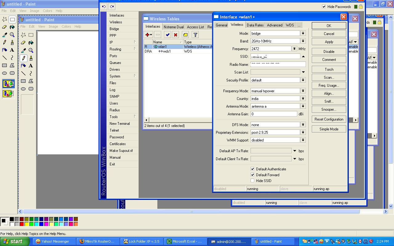

Data rates were set as default. i’m attaching jpg file of my configuration, please let me knw if any other information needed.

why you use 10MHz channel?
