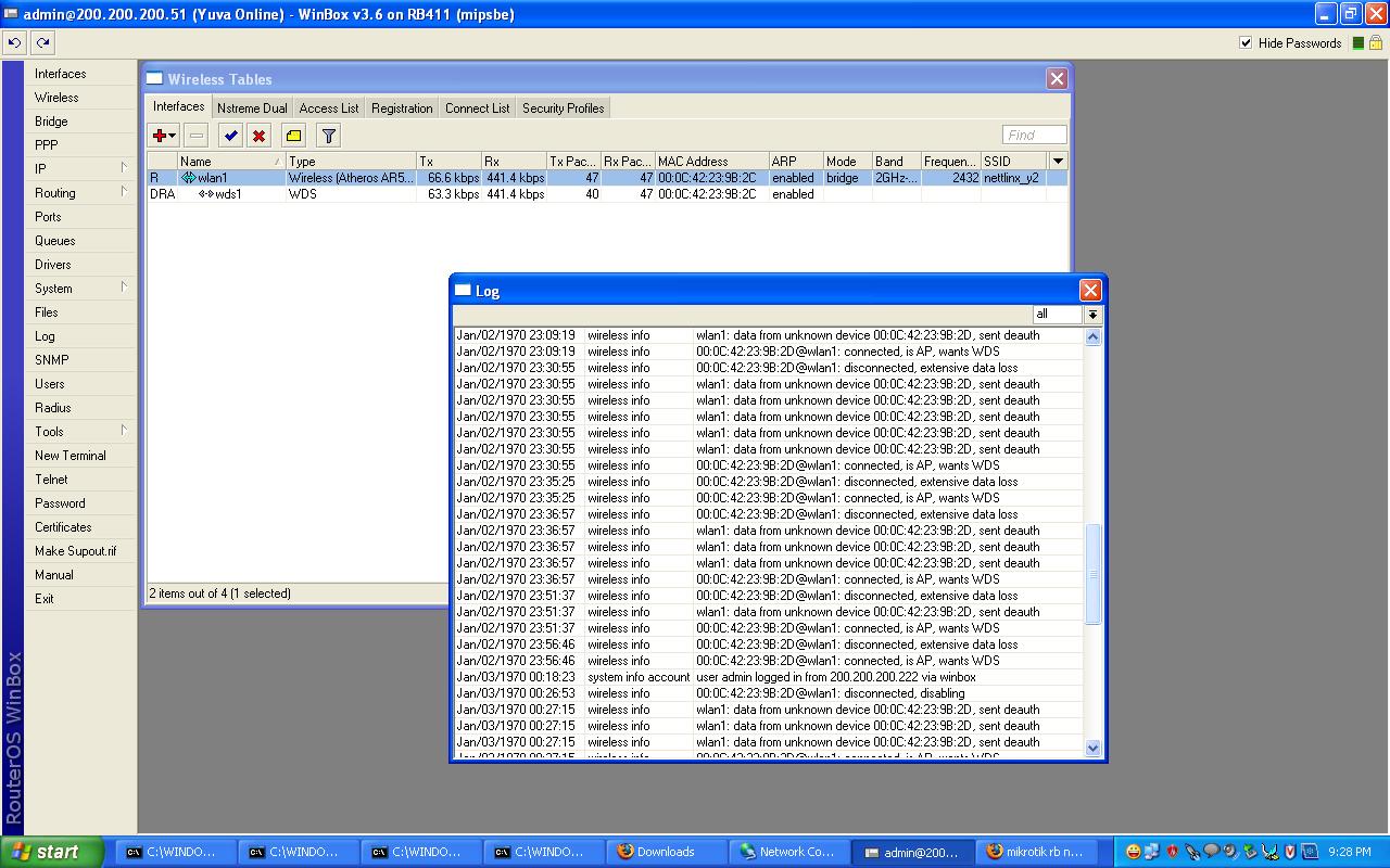

I found my RB411 log something like — sent deauth and extensive data loss
The same screenshot has been uploaded… i want to know the reason about this error
plz help me
plz help me
are wireless problem! set an link with an good ccq! Probably the frequency used have an hight noise floor
Check the first thread in the wireless networking section! It is sticky so that everyone see’s it. It is called Wireless disconnection messages explained!
No really, you should look.
