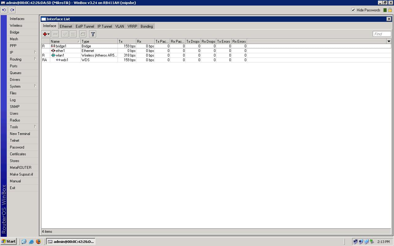

I have such problem, I have 6 mikrotik routerboards connected to each other,
10.1.1.1 <------> 10.1.2.1
10.2.1.1 <------> 10.2.2.1
10.3.1.1 <------> 10.3.2.1
today 10.1.1.1 and 10.2.1.1 stopped working, than i have connect my laptop to 10.2.2.1 and in my winbox a saw 10.2.1.1, I have logged in and problem was that mikrotik was working but on intarfesis ethernet tx rx bytes was zero, what can be the problem???
Please help me, wireless is working but ethernet not, POE works good too

The chip, controller of the RB411 has burned out. This happens mostly after thunderstorms and faulty grounded ethernet cable.

Often the Ethernet Cards burn out (with most equipment) if you have cables that are not precisely grounded. We tell to our customers to use UTP when they have not a good grounding. From our experience UTP is better than FTP in these cases. Of course FTP is the standard for outdoor use, but we have found that the ethernet cards failur decreased when using UTP in not grounded systems..
