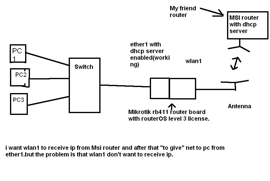

i read a lot of pages on this forum and wiki and manual and nothing worked except a dhcp server for LAN side.my configuration in picture.
Please help how i must setup to work like in the picture?(sorry for my english mistakes)

Fixed,the problem was the wireless card,partial damaged,wlan had very low emissivity power,now is working(i replaced the card),i can acces the internet via MSI router,but i cannot acces computer behind msi.
MSI router has 192.168.1.1 my friend pc has 192.168.1.77
mikrotik wlan has 192.168.1.80(received via dhcp from MSI) GW 192.168.1.1
PC1 has 192.168.50.5 GW 192.168.50.1 received via mikrotik dhcp server from ether1
mikrotik router has 192.168.50.1
what should do so the PC1 192.168.50.5 to be able to acces and ping 192.168.1.77.the mikrotik router can ping my friend pc.
Those are two different subnets. You need dstnat.
http://www.mikrotik.com/testdocs/ros/3.0/qos/nat.php
