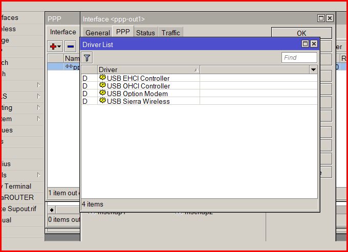

I am trying to get a connection with Sprint using 3G and/or 4G.
So far I am trying to follow this guide… http://wiki.mikrotik.com/wiki/Option_Globetrotter_HSDPA_USB_Modem
Could someone help me with the correct settings to get this to connect to Sprint?
[admin@MikroTik] /interface ppp-client> print
0 name=“ppp-out1” max-mtu=1492 max-mru=1492 mrru=disabled port=usb2
data-channel=0 info-channel=0 pin=“” user=“” password=“”
profile=default phone=“” dial-command=“#777” modem-init=“”
null-modem=no dial-on-demand=no add-default-route=yes use-peer-dns=yes
keepalive-timeout=30 allow=pap,chap,mschap1,mschap2

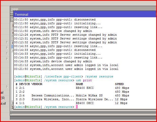

Have you checked all suggestions from,
http://wiki.mikrotik.com/wiki/Option_Globetrotter_HSDPA_USB_Modem#Typical_things_to_check
  • different port;
  • async,debug logs could provide with additional information about the problem.
Thanks for the help but I am currently at my knowledge limitation with this. Any pointers would be nice or if I could pay a consultant I would be open to that.
you haven’t posted any actual problem description. please tell us what the logs say, as sergejs already asked.
