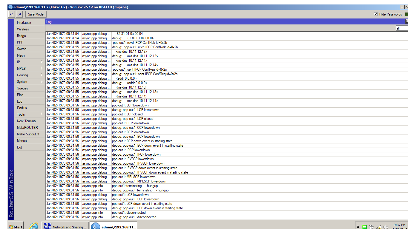

It’s the latest 5.12. tried running at+cfun=1 and also tried putting it in the init command. Since upgrading to RouterOS 5.12 about a month back the modem has actually been a lot worse. This modem is actually used at a clients premises so it’s kind of hard to debug but I thought the combination of Sierra MC8700 + Routerboard would be extremely stable hence why I recommended it.
Attached is another log from the client which appears to be a different issue than the last. Apparently the MC8700 + Routerboard would notmake a connection where as their cheap usb modem would.
The MC8700 has proven to be an extremely well performing modem so it’s a shame this setup doesn’t work reliably.

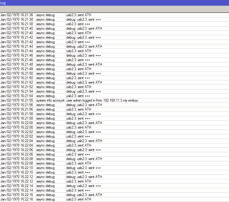

Hi, I have similar trouble with MC8775 3G PCI Card.
Continously sent +++, sent ATH.

My first doubt: why “ports=0” ???
then, after created PPP-client interface I have:
Couldn’t continue - modem did not respond (6)
when I press Info… button.
at the end, if PPP-client interface disabled, I try
system serial-terminal port=usb3 channel=0
then I haven’t any answer by modem on any (0,1,2) interface.
Any ideas? Both RB411 and 3G card are new devices.
Thanks.

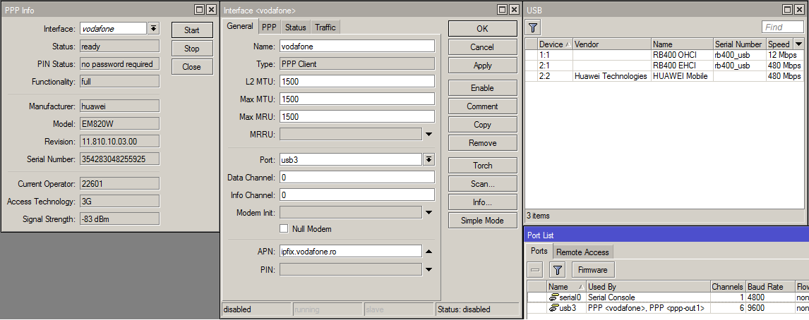

Hi ibm390s,
could you tell me if you had to go through any special steps to get the Huawei em820w to work. I tried RouterOS 5.22 and 6.0rc4, neither detected the USB device. Also upgraded my firmware 3.0. The board simply doesn’t detect the modem - I just want to be sure it’s not a software/driver issue before I go through the motion of RMA’ing my modem.
Thanks!

@MTFan
No special procedure needed. Just inserted the card in the slot, secured with the two screws, powered the RB411U and the modem was detected by the OS and drivers were loaded.

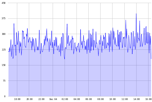

This is the daily chart for a RB411U + EU870D which i test right now. Fixed IP from the carrier (vodafone) testing with ping from The Dude. Stable over the last 30 hours. After reaching at least 6-7 days of uptime for the link i will start to test the Huawey modems.
