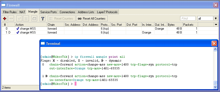

@surfertim, Thanks a million for your support. Turns out that the problem was in mangle.
When connecting to orange using the RB411U/Huawei E156G one rule was automatically added in mangle. The rule is changing the MSS for all outbound TCP traffic. The mistake - or the problem is that no rule was added for the inbound traffic. When adding the same rule for the inbound traffic everything works fine.
Credit to my friend from CZ for solving this problem. That was a real tough one.
rgs Pilgrim
