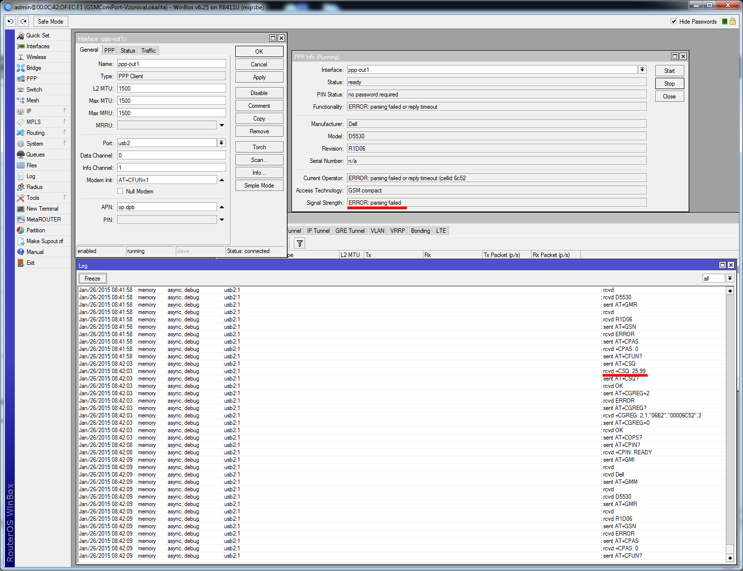

rsaf
January 26, 2015, 7:46am
5
I have same problem with DELL D5530 card. Signal strenght is read by AT+CSQ command in debug output but (and i think that format os correct) but not shown in PPP Info as shown on screenshot.
