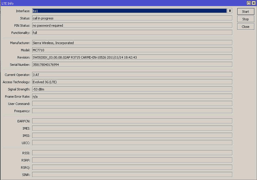

Thats quite a bit more. Which firmware version do you run on the module?
With my 9dbi antenna I have roughly -58db and sometimes even better, so I assume reception is not the problem.
Do you use the auxiliary antenna?
PS: added a screenshot of the lte interface status.
Nope, i dont use the aux antenna. your signal is great, i dont think that is the problem.
