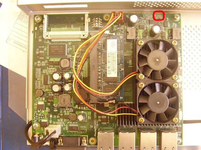

Last year I had problem with nearly 10 RB1000s where I had to replace one of the capacitors on the mainboard (because of design bug) to fix the problem.

Any chance you can provide further detail about which cap and what value you replaced? I’ve got a RB1000 that will crash randomly between 7 and 30 days. Does not appear to be a traffic or load issue, and does exactly what you describe - goes cold and needs to be off for 10-20 seconds to come back up…no ip, no console, and of course no supout :confused:

It affected only the old versions of RB1000, you can preferrably send affected devices to RMA or fix them yourselves (possibly losing warranty) by changing C309 to 0.1uF 0402 capacitor. Beware this capacitor is really very small in size :slight_smile:

Thank you very much for the info..that thing is tiny! So far I’ve looked at 2 RB1000s I’ve got on hand (one is DOA and the other just came back from RMA which was also shipped DOA) and I’ve noticed that in your pictures there is a cap 301 next to the 309. Neither of my boards have a cap soldered on at 301, so maybe these are the newer boards? Either way, I appreciate the info and will take a look at our problematic RB1000 once I get a backup installed.

It’s not C301, it’s R646 (I understand that resistors are black, and capacitors are bright). You don’t want to solder it in.
I replaced C309 in one such board and it’s ok. This one was particularly problematic before.
By “ok” I mean 10 months without any single issue on all 10 devices up to this day.
