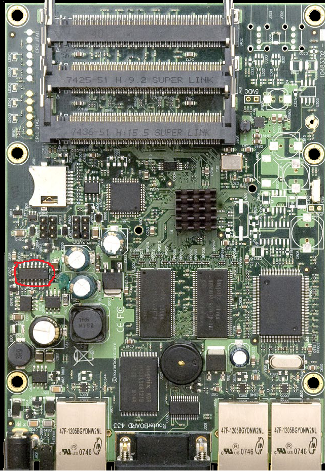

Hi
If you plug/PoE or Direct DC/ and there is no light up I think that the problem is here:(look at the picture)
Not always, power controler not dead by itself.
1 of my 3 board is the C829 issue, after remove, it’s working fine.
BTW, there is another 2 still no working and nothing i can do with it…
This, should send for RMA.
