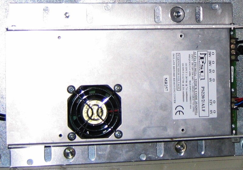

Radios are 2 x R52H.
The PSU is actually quite a fancy beast. It crashed. The entire processes repeated itself two hours later. I replaced it with a MikroTik 24V PSU and so far so good.
Here are pictures of the cabinet and the PSU.
Power is provided by a 1.8KVA UPS.
