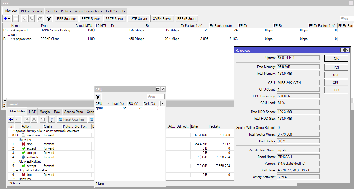

bematft , i have rb433ah too with 2 ar9223 wifi cards . My ISP gives me 100/100mb/ps pppoe client . I achieve real 95/95 with 80-85% cpu load with fasttracking enabled over lan ethernet . Over wifi the load increase much more - same load only ~60mb/ps .
