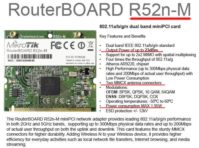

Thanks, Can you Pls review (R52n-M), i highly expect your affirmative feedback regarding R52n-M will be the proper match for RB433AH. (pls refer the attached spec of R52n-M for further info.)
i dunt think R52n-m is available in market
