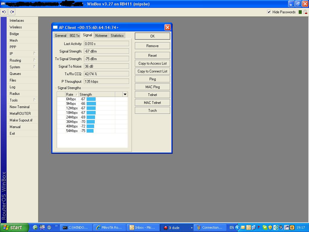

I am seeing the the P Throughput on the CPE links going from 28Mb-s to 160kb and fluctuating wildly. The links are clear line of sight and less than 4km. Nearly all CPE TX/RX signals are in the -70dbm range. I only have Mikrotik connected the the AP’s and all CPE are running ROS 3.27 only. See CPE Registration Details and P Throughput in photo below.

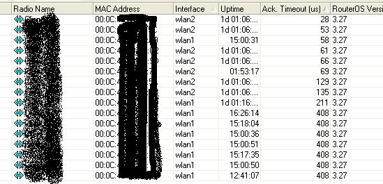

I have also seen very high ACK’s on the AP’s Registration Table +400us. See photo below.
I have tried turning off the Horz sector but the problem still exists on the vertical. I have also tried changing the channel but this does not fix it either.
This is driving me crazy and I really need to get this fixed. Please contact me directly if you want to team up on solving this issue and comparing notes.. I am ready to throw away the XR5’s and go back to R52’s but there must be a fix for this.

What is your noise floor? While you may have good SNR, you may still have a high noise floor with two high power radios in the same enclosure with no space diversity between antenna elements. We don’t use the dual polarity antennas because there is no space between the elements and you do get cross channel interference. Yes you sometimes can make it work, but why go with sometimes…you want all the time.
The one image shows a good SNR but a bad CCQ, which is indicative of channel congestion. My guess is that you have a wireless frame timing issue where the two radios are sending at exactly the same time, or close enough that they are killing each other on the antenna element (with no space diversity). It appears as lost frame, not as noise to the receiving end. So you have a collision between frames on different frequencies.
A guess, but probably close to what is going on.
