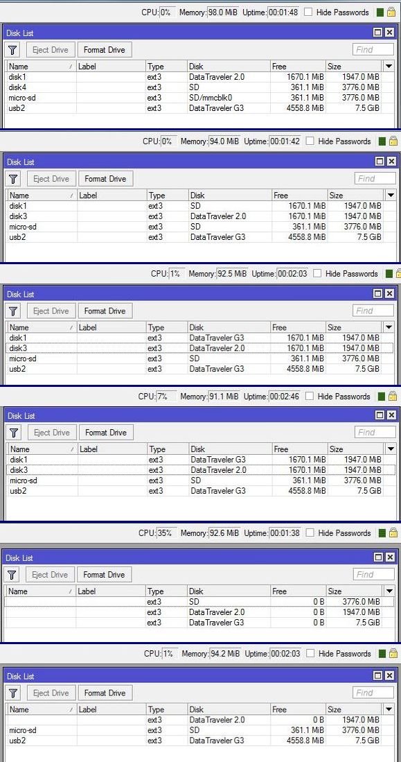

Mám od verze RouterOS 6.20rcX do současný 6.24rc8 stále problémy s disky v routerboardu.

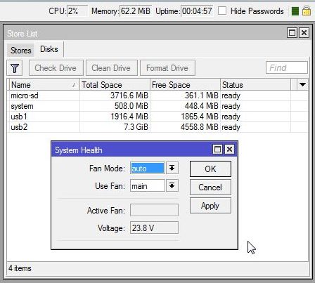

Disky se po restartech nebo aktualizacích ztrácí a tím nefunguje proxy cache. FTP přístup na disky je možný stále. Info o napětí routerboard ukazuje po restartu pokaždý jiný stav v rozmezí 19V - 21,8V. Nevypisuje hodnoty v reálu jak by si každý myslel (v6.19 info 23V - 23,8V)

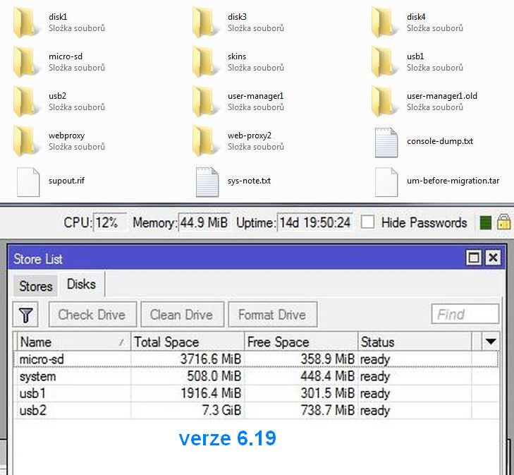

Verze 6.19 s disky pracuje jak má. Chyba se tam neobjevuje, proxy cache funguje.

Přikládám obrázky se sestavením 6.24rc8. Jsou to snímky po restartu (reboot nebo power off/on) routerboardu.
Obrázek z verze 6.19 je po sesazení z verze 6.24.rc8

I have a version of RouterOS 6.20rcX to current 6.24rc8 still have problems with discs routerboard.
Discs restarts after updates or loses and thus does not proxy cache. FTP access to disks is still possible. Info on voltage routerboard shows after reboot every time another state within the range of 19V - 21,8V. Do not print values in reality how everybody thought (v6.19 info 23V - 23,8V)

Version 6.19 Discs working well. The error does not occur there, proxy cache works.

I attach pictures to the drawing 6.24rc8. They are images after the restart (reboot or power off / on) RouterBoardu.
Picture from version 6.19 after downgrade from version 6.24.rc8

does the router restart itself? if yes, make a supout.rif file and email to support. if possible, include remote access details.
forum is not an official support system, to receive support email support@mikrotik.com
is manual reboot (deliberately reboot, power off/on) demonstration error load discs (6.20rcX - 6.24rc)
downgrade to 6.19
Unable to delete folder directory (disk1,disk3,disk4)
FTP connect shows folder (disk1,disk3,disk4)
WinBox no shows folder (File list window)
