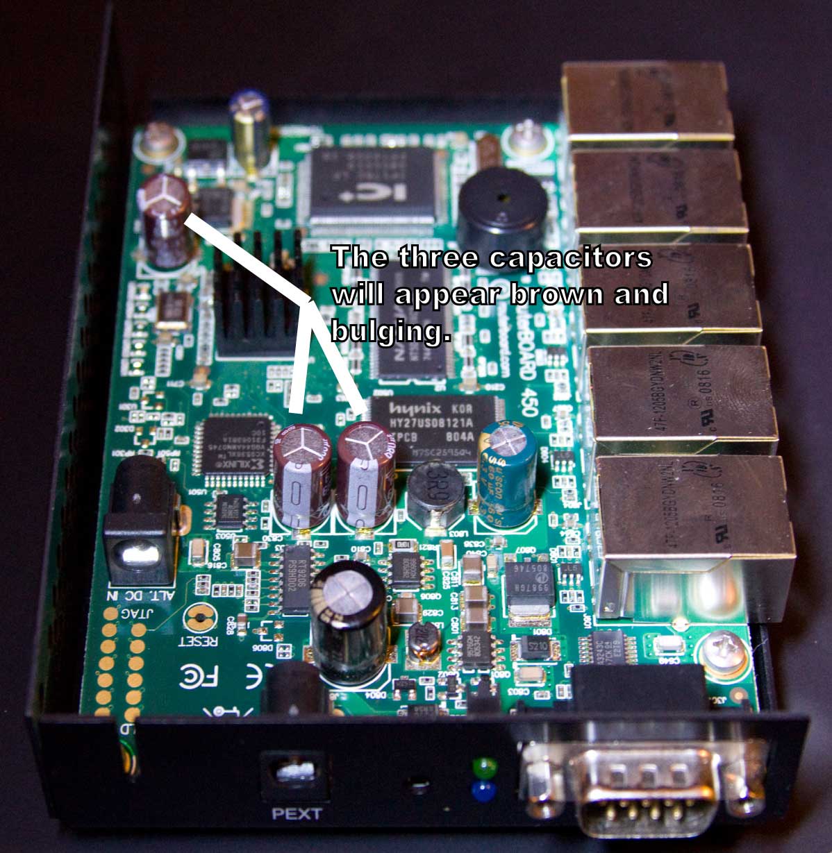

I purchased 20 RB450s in 2008 from Tom at Roc-Noc. During 2009, each of the 20 failed. Tom mentioned that Mikrotik was aware of the capacitor issue and would offer a replacement of the 20 RB450s. In that time I’ve received a partial replacement. Sadly, due to the substantial delay in receiving the remainder of the RB450 replacements I’ve had to implement my own repairs, replacing the 3 capacitors in the picture below.
If your RB450 fails, you will see 3 bulging and brown capacitors in the areas I’ve pointed out below. Replace those and your RB450 will be functional again as well as not having the issue where a rapid power outage will cause the board not to reboot.

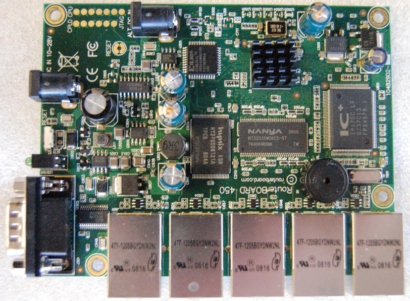

I’ve got the same problem, here’s some photos of the bad caps

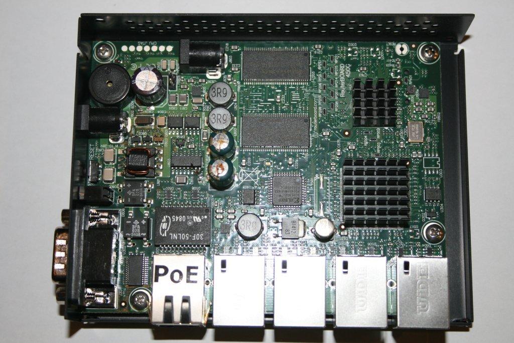

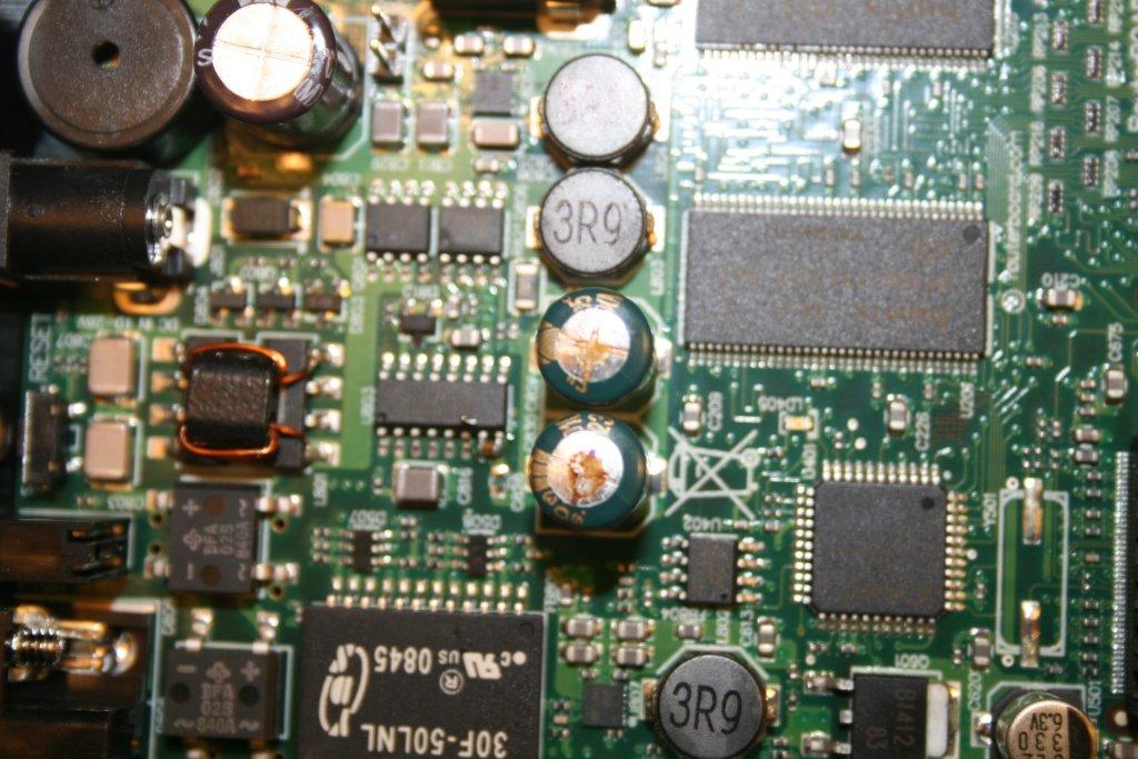

I just had this happen to a RB450G I own. Here are the pics:
I will have had the unit for a year next week. I bought it from rocnoc.com, so hopefully they can repair/replace it for me. Otherwise I’m going to have to learn to do some soldering I guess. I’m not very happy about this :frowning:
