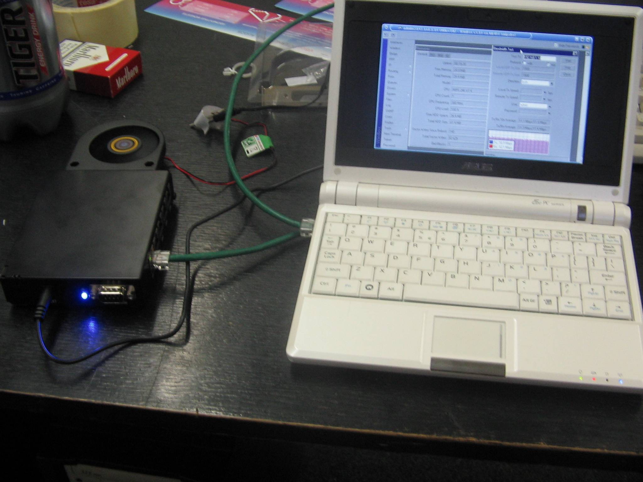

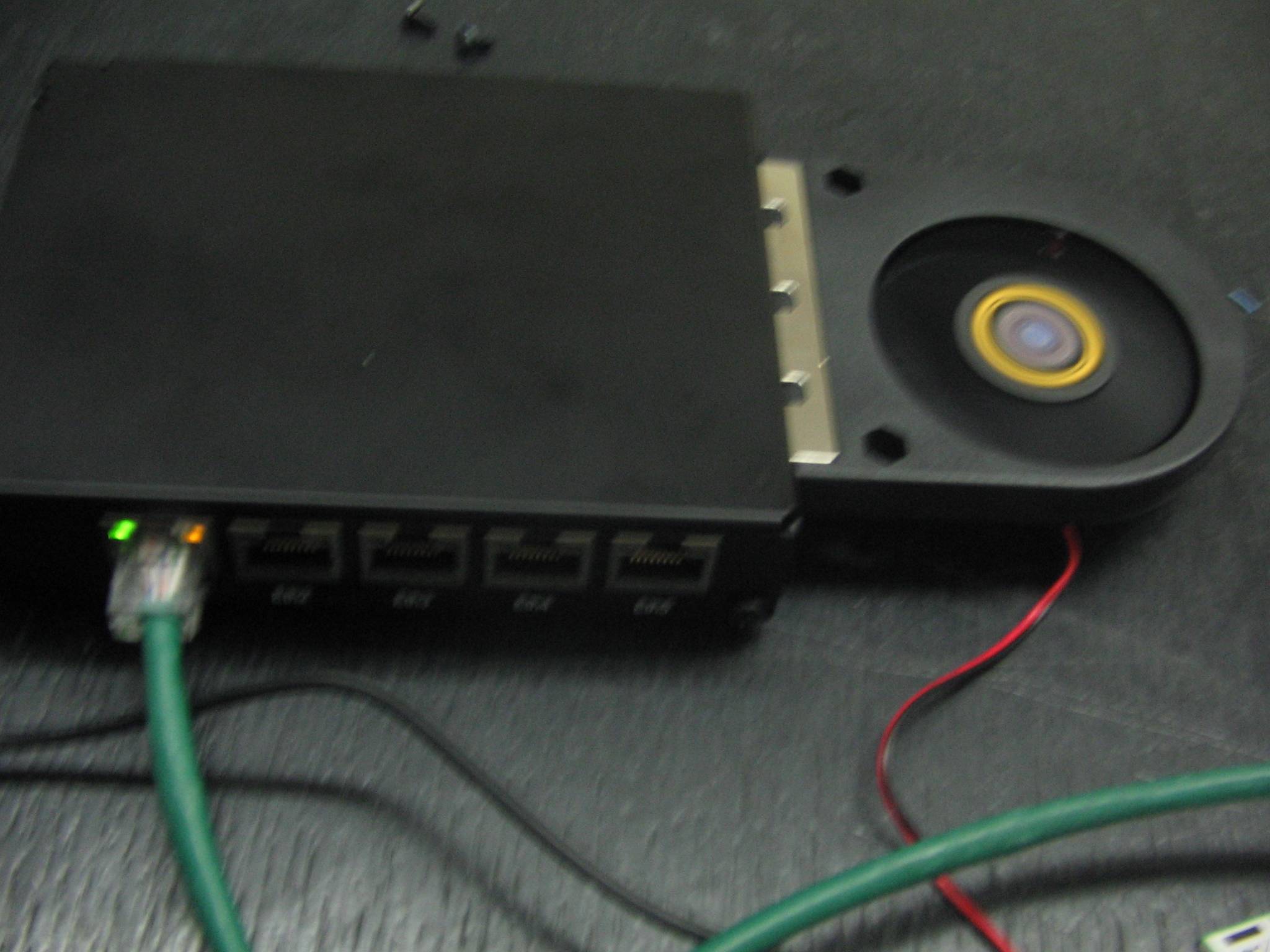

Well i found a solution. Its titan pc case single slot cooler. It blows air into routerboard and cools all system. Just use 12V adapter (from switch or something). Air goes out from lan ports and other side holes. Screws fits perfectly. It just get bigger and noisier and cool. And needs 2 electricity outlets.
Sad that rb450 hasn’t thermometer.
P.S. sorry for big images.
